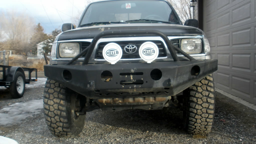

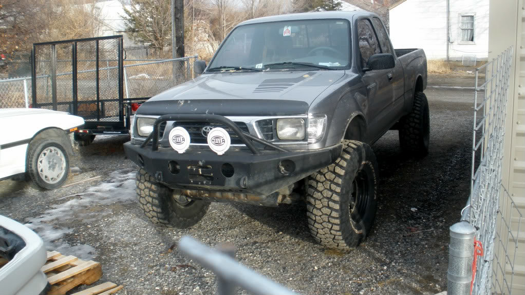

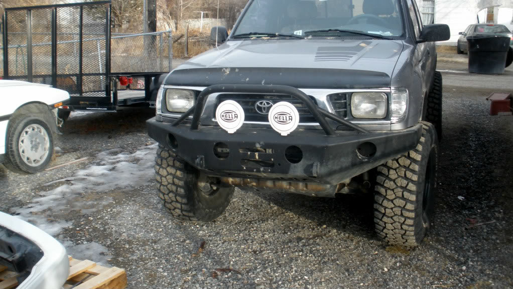

    Are these pics with or without spacers? 15x8 4" backspace with 33x12.5s right?

    Without spacers. And yes, 33x12.5r15 and 15x8 with 4" bs.
    The video is 31x10.5r15 on stock 15x7 at 4.5" bs with 1.5" wheel spacers.
    I rubbed the frame at full steering lock though. Thus the spacers went back on.
