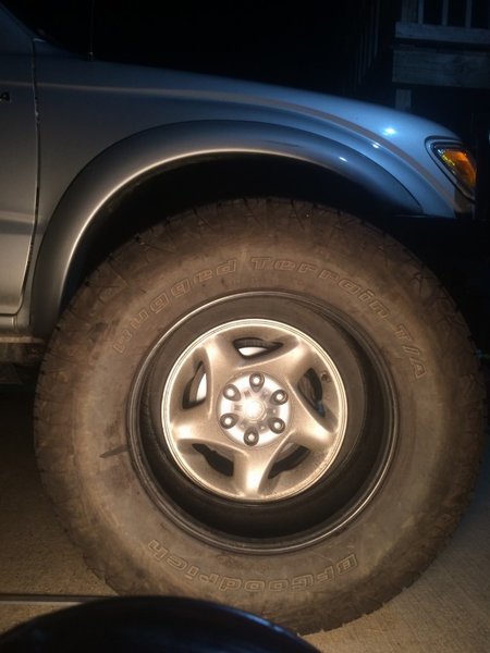

    Awesome, I didn't think so but I'm no expert about IFS.
    Yeah, not planning on needing the welder.
    I have a tire off of our f250 that is very close in diameter (Supposed to be within .2") and almost 3/4" narrower than the tires I want and it looks massive rolled up against the current 265's.
    Sorry for adding more pictures to your build.

    Don't be sorry, tons of photos in here no pertaining to Frankenstein. I don't care, its what we are talking about haha
    What tires are you getting?
    305s?
    or 295s?
    Everything looks huge compared to 265s lol i doubt you'll have to tub, and i hope you don't have too. not a fun job.

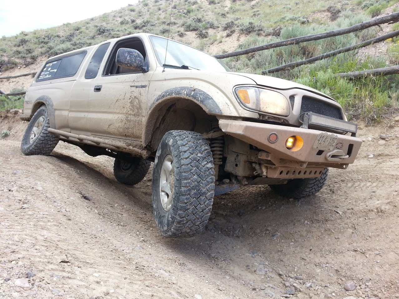

    Doesn't seem like Monte touched on this so I'll add this: it really all depends on leaf springs and shackle setup. Back when I ran longer shackles, I would eat the front of my wheel wells pretty good. I also understand this is the case with Dakars regardless of shackles.
    Back to stock length shackles, a very minor trim on the front, lower portion of the rear wheel well, and I'm fine. Stuffed the shit out of it yesterday and zero rubbing with my 295/75s:
    pKFp6iS-_vwbI9iz5p9Yi0bPa-I6ueAf4fxBhGaa_5db90f630b02c2d502c9e6ae0af36364a584edf2.jpg

    ahhh yes that is a very good point about the shackles. Definitely changes the way the wheels travel. Good point Brett.
    :thumbsup:

    Good to hear (Nice pic BTW) I figured I'd need to pull my mudflaps this go-around.
