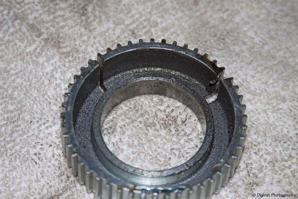

    Check this out. I think this is called the ABS ring. It is part of the rear axle bearing and seal stuff.
    I'm pretty sure its not supposed to look like that. :oops:

    Good thing you removed it. Less crap to go wrong. :oops:

    Ha, I've been told you cant run without it. My truck does not have ABS from the factory.
    FWIW, that piece was brand new. Only 2300 miles on it.

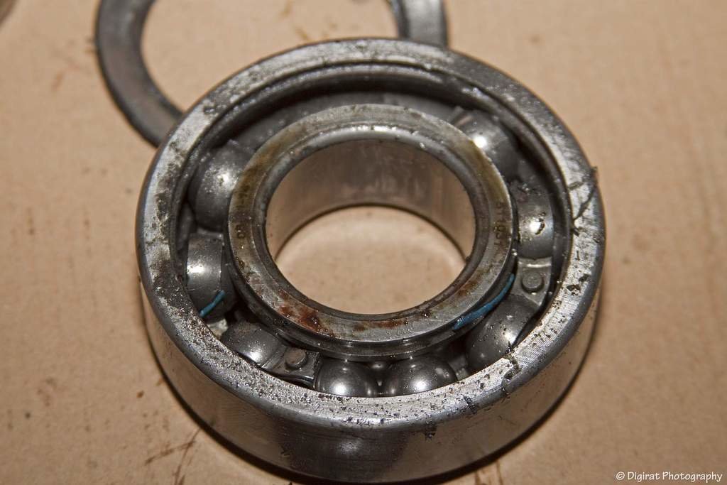

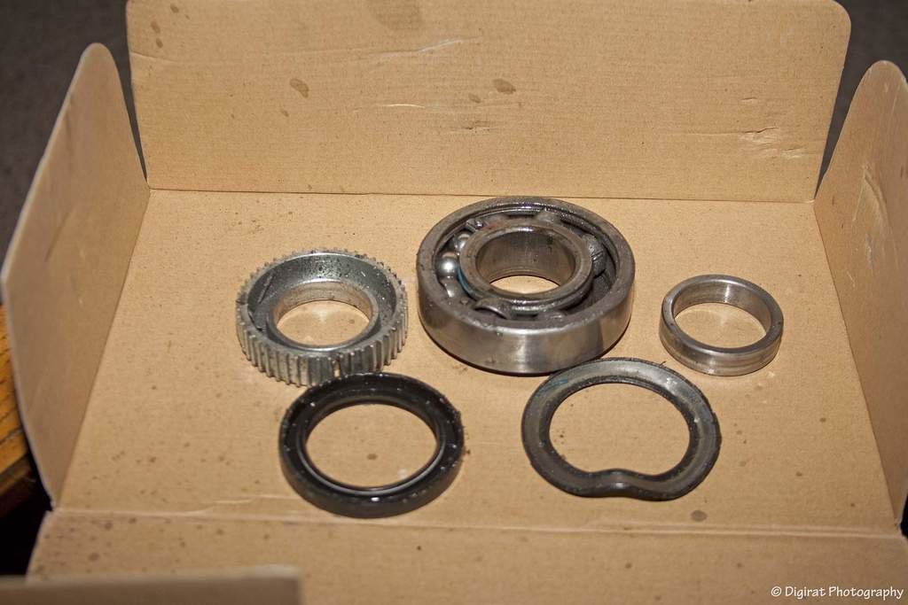

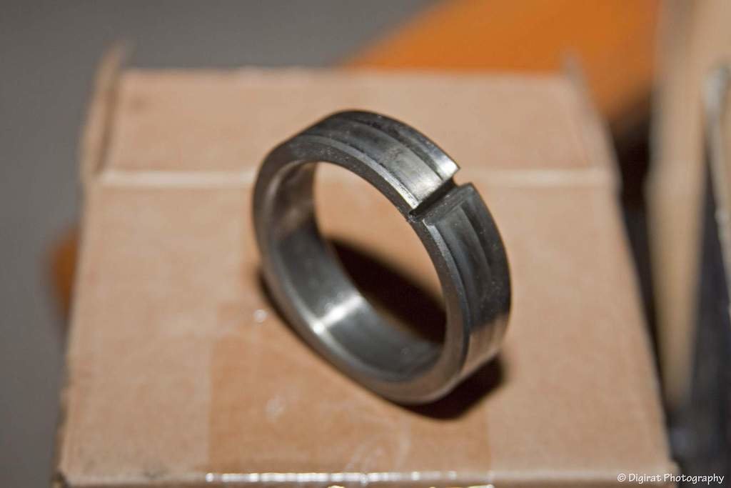

    This was also in there.

    interesting.
    was the bearing a Koyo?

    The markings indicate it was Timken

    Well actually, both sides are now aftermaket. Alpine Toyota said the earliest they could get an OEM bearing was Saturday or maybe even Monday. I could not afford to wait.
    In either case, this Timken bearing should not have failed so quickly, OEM or not. I suspect it was not properly installed but it may be difficult to prove that. The report from the Toyota tech was that the bearing failure caused the seal to fail which I think is the opposite of what occurred originally.
    Are you certain that Koyo is the OEM brand for this application?
