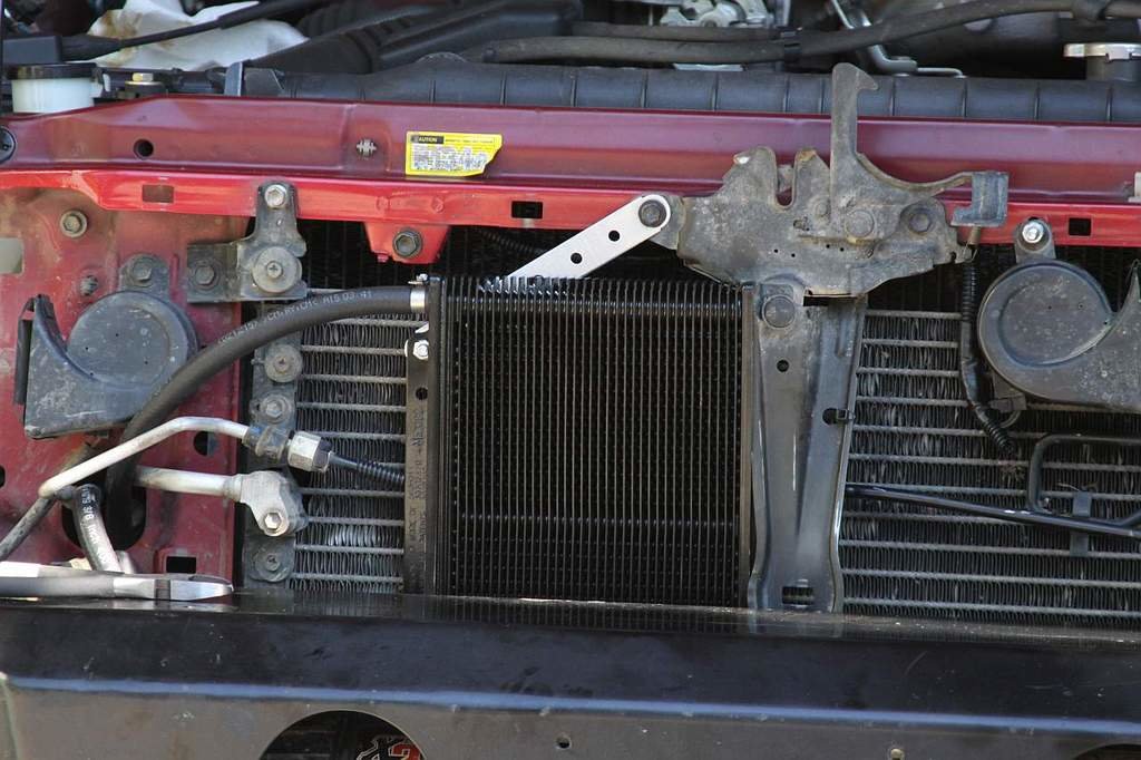

    I did add that cooler and it did improve things but adding more hp will only stress that system more. Also, I used the largest passive cooler that would fit in the space.

    Where is it again?
    Have you thought of doing a Satoshi grill and slapping a big ass one right behind the grill?

    That is where it is. On the passenger side in front of the radiator. I had to move one of the horns to make room. Can't do it on the driver side because the A/C lines are there. And can't go any lower because the bumper and winch stuff is in the way.

    No the AC lines are right there. You already have it routed by the AC lines.
    Id think you could get something bigger in there. If you did the Satoshi that maybe used the BAMF light bracket to mount it you could double or triple the length. Or make some sort of mount for it. The lines could stay on that side and it would just be the full width of the grill. But you'd have to do the satoshi to clear the horn and hood latch.
    something like this http://www.xtremediesel.com/Flex-a-...4qmVUwKP1lQTcV635sr3WoYW7yg7lMn1CHRoCqpLw_wcB

    Not more than the two mishimotos..
    15x7.5 and 20x7.5 both are .75 thick.
    Thats 79.75 vs 112.5 vs 150. Almost twice the surface area for the bigger one..
    Mounting wouldn't be that hard. Just a couple of brackets.
    Only other way you could do it is in the bed with a fan too. And i know you don't want to do that either.
    so suck it up princess and deal with it :D :luvya:
    Obviously doing a manual swap is the easier choice at this point...:D
