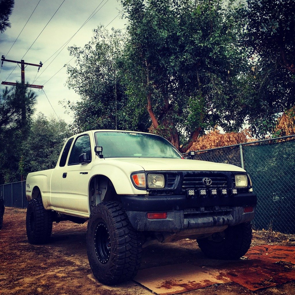

    Subbed been really digging deep in your build thread cause I got a 97 and your build is my goal monte
    F753E4D2-FAEB-418D-A40F-951C2FA5CD51_zps_afb989cdc7e69abdf19f575553da00ff1599e22d.jpg
    in a couple months I will be picking up the MCM long travel already talked to matt about it and will be meeting up. stock bumpers will be gone soon also. if you dont want this on your thread go ahead and delete it haha just thought i would stop in and say hello! Thanks for all the awesome write ups and ideas:popcorn::thumbsup:

    Nice truck and a good start but if you want to be like frank, you need more lights.

    hahaha im putting a 42 on the windshield then im done haha

    Awesome man! Glad to inspire! You'll love the MCM kit too man. Was stoked from my last trip getting to really strech out the legs. Truck looks good! Watch those cv angles too.

    Boots slip off or what?

    With too much front lift you makes he cv boots rub. The fins touch and as you drive they wear grooves into themselves then bam. Blown boot and grease everywhere.
    Plus you have no down travel and that makes for a shit ride.
