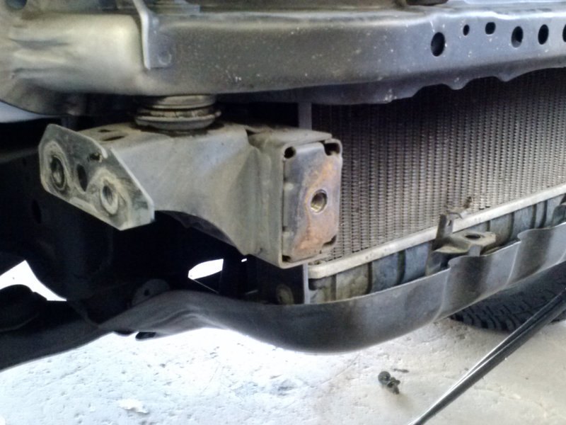

    Here is what the frame horn looks like prior to cutting and capping for a winch/ plate bumper:

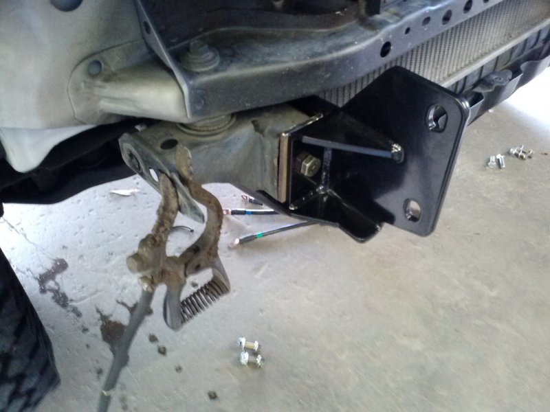

    Here is what mine looked like prior to welding. In this photo, it's line up and ready...

    Mine says I can use the stock end caps, perhaps when I fit a winch to it I'll weld new ones on. For the time being I think stock should be fine.

    Honestly, while you have it apart, do the frame horn mod. The OEM front caps are weak which possibly, if you hit your bumper landing from a launch or hitting while exiting a radical decline, you can pull them out, damaging the frame.
