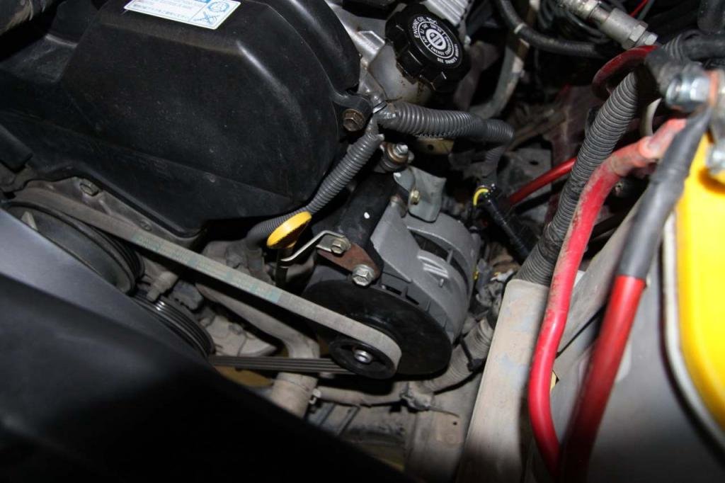

    Monte, just picked up the GM Alt. Holy shit its big... How did you wire it up, you got any pictures?

    This is what I'm using:

    Monte did the swap on my truck for me. I recall there being only a couple of slightly tricky spots. One was figuring out how much space was required to fill the gap for the main mount to the stock bracket. The other was adapting the 3 wire stock connect to just two wires. One thing we wanted to do was to be able to swap back to the stock alt easily as a trail fix in the event the GM alt failed a long way from home.
    Here are a few pics a took of the swap:

    What year and model vehicle did that come out of? I was looking at ho's and can't find one that 12-6

    Yea I have lots. Give me a few minutes. I just got home from being out all day working and have only eatten a pop tart...12 hours ago. #audiorecordinglife lol

    Thanks man, much appreciated. I had to remove the lower bracket (for the tension adjustment nut) just to fit it in. I'm going to pick up a GM pig tail tomorrow.

    Hold up a sec. Did you change the pulley on yours? Or did you get one with a three rib pulley?

    Looks like he just swapped his stock pulley to it which will work
