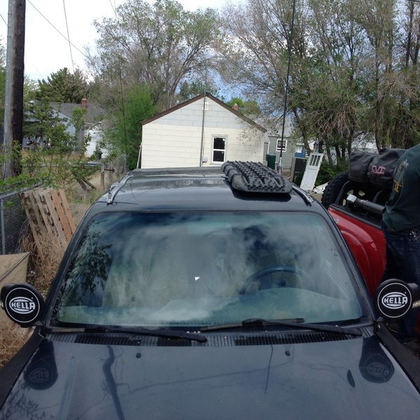

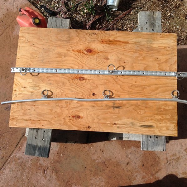

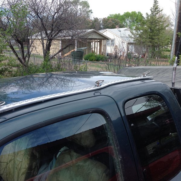

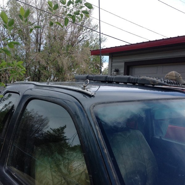

    Okay. So here's the deal. I have been missing my old roof lighting setup ever since I took it off. But did not want a big basket again. I realized I didn't use the basket enough and it caused WAY too much drag to make it worth it just holding lights.
    So I spent a while trying to figure out how to make the lowest profile roof rack ever. Jon stepped in and we started talking about it. He had an idea and went for it even though I wasn't super sold and didn't love it.
    I had envisioned something that followed the roof line exactly. Jon came up with a way to cope with it using aluminum rails and was going to make custom mounts for them. Well instead, I'm sure after some courage juice. He just said fuck it and slapped the rails in the vice and started bend it. And it came out PERFECT.
    Lo and behold. My new roof rails courtesy of the skilled hands on Jon
    They aren't pefect just sitting on there. But once the bolts go in. It'll be perfectly flush.
    My sole purpose of this is to hold a couple small led bars facing out to the sides and to hold down some maxxtracks. Will work perfect for this! I will bed line the roof and am going to try the tintable raptor liner to see if possibly doing the whole truck in silver is probable.
    And when the maxx trac aren't on the roof. Then I have nothing causing obscene drag.
    I'll be mounting a rear led bar from rear led lights to have tail lights, blinkers, and dust flashers and rear lights.
    For the front...well...
    Cheap ass ebay bar. Nothing special. And before everyone jumps down my throat, it isn't my main light and I don't expect great things. I still will depend on my light forces and the two hella hid lights for my main distance lights. This will just fill the void between them.
    So yea. Pretty excited about the roof setup! Need brackets for the front bar. Need to order the side bars and going to move my HAM radio antennas to the roof. So two big holes in the roof and a lot Of small ones...
    Stoked!

    I must admit, I am a bit confused by this. Is it correct to assume there will be some sort of crossbar attached to these rails? Something to support items like the maxtracks.

    Nope, nothing. Just straight to the roof.
