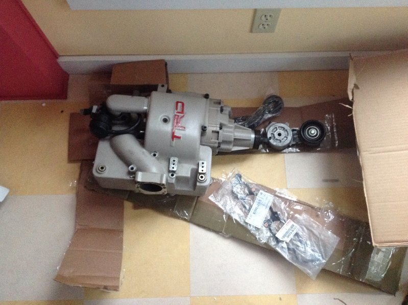

    Nice, lay out everything you got from him and I'll let you know what you're missing. You'll be boosting soon enough.
  4. Jul 3, 2016 at 10:54 PM
    Blackdawg
    Blackdawg [OP] Dr. Frankenstein
    Dec 31, 2010
    #48500
    81,640
    Monte
    Wyoming/St. Louis
    The Trifecta of Taco's
    That is everything.
    I swore he had bolts. But claims he didn't so yea..I have nothing other then the dynamic tensioner, no bracket, and a gasket and belt.
    Nothing else.
    Other then a 7th injector coming and 2.1" pulley

    Near as I can tell, I need:
    https://trdparts4u.toyotaofdallas.com/scripts/prodView.asp?idproduct=-9052 = $294.99
    https://trdparts4u.toyotaofdallas.com/scripts/prodView.asp?idproduct=-8180 =$342.18
    https://trdparts4u.toyotaofdallas.com/scripts/prodView.asp?idproduct=-8157 =$38.40 x2
    Sooo...
    $713.19..ouch
    Unless you have a cheaper way of getting the mounting hardware and stuff. Pretty sure I'm screw on the bracket.

    Ordered my parts. Camelback came through. Only 498 bucks vs 710. Not bad.

    Did you get the iac check valve and the tb gasket?
  11. Jul 4, 2016 at 10:57 PM
    Blackdawg
    Dec 31, 2010
    #48500
    81,640
    Monte
    Wyoming/St. Louis
    I bought the install kit...so..better have that shit

    2006 Tundra DC, TRD, 4wd
    Cancel the first item, it's pretty much useless besides the throttle brackets, which are easily made. The hosing is completely different on The 1st gen and the 1st gen uses 3 long bolts not one. The spacer in that kit isn't needed and the T's are different.
    The tensioner kit is what you need and only available through Toyota.
    The spark plugs are fine but expensive. I'm assuming you knew you got IK20's. The typical colder plugs are IK22's which are two step colder than stock. The 20's are 3 steps I believe and might cause some issues if you don't have the 2.1 and 7th installed. Not entirely sure.
    I actually bought some NGK copper 3 prong plugs that are equivalent to the IK22's. Cost me about $10 for all 6, I have a set I could sell you if you want to cancel those.
    Nope, need the IAC still needs to be ordered...PTR2635042
  18. Jul 5, 2016 at 10:55 PM
    Blackdawg
    Dec 31, 2010
    #48500
    81,640
    Monte
    Wyoming/St. Louis
    Damn..
    I thought I read the IAC came with the kit. And it has the 170mm bolt to mount it I need.
    So where can I get the bolts?
    I am going to run a 2.1" and 7th injector.
  19. Jul 5, 2016 at 11:00 PM
    SCRunner12
    SCRunner12 Tundra Troll
    Aug 8, 2011
    #61363
    9,115
    Robert
    Santa Cruz, CA
    Now that I look at it, it does come with it but it's literally a $6 part. I would return/cancel it and source the parts you need.
    I might have the bolts, I can check tomorrow for you. The 1st gen needs two 170's and I believe a 185 or something. Will have to look through my PM's at T4R.
  20. Jul 5, 2016 at 11:01 PM
    Blackdawg
    Dec 31, 2010
    #48500
    81,640
    Monte
    Wyoming/St. Louis
    Okay I'll call tomorrow and cancel it. Other then the dynamic tensioner kit.
    Id appreciate any and all help locating the parts.
