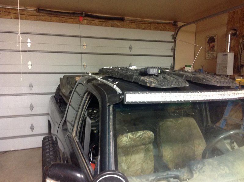

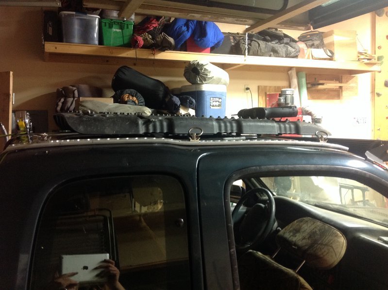

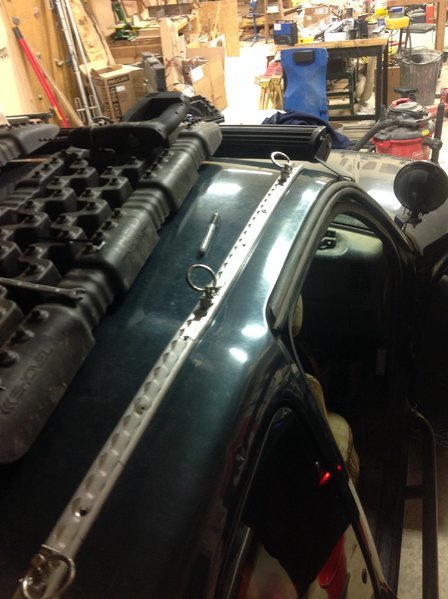

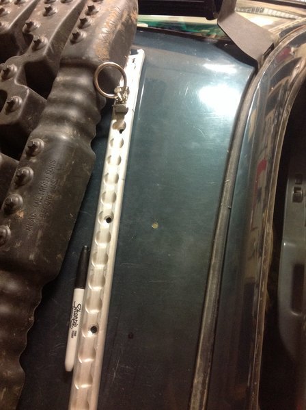

    Started the process to mount the roof rails. Going to work great.
    I'm not sure how to go about painting them yet. Might just bed line them at then ame time as the roof ha
    Digging the roof setup though. Going to be nice and simple.

    Drop bracket lift and booger welds
    Will there be crossbars?
  19. Jul 12, 2016 at 6:37 AM
    45acp
    45acp Paint me back in Wyoming again...
    Aug 9, 2009
    #20861
    6,706
    Jonathan
    Boring, Wisconsin
    1981 Long bed 4x4
    Painting them? They'd likely just get scratched up from the tie down points. I'd just leave it bare, use some clear, or maybe powder coat? Or better yet, cover the top face of the rails with tape, and then hit the sides with the raptor liner at the same time that you do the roof and help create a seal between the two.
    As for crossbars, I think the best best is some solid aluminum bars between the roof and headliner to help support any additional weight on the roof.

    Nope. Nothing heavy is ever going up there. The only thing that will is the traction ramps.
    Well the tie down points won't be moving. So figured painting with bed liner would be simple enough. Though I've thought about PC. Maybe at some point I'll pc them. Don't like the bare look though but looks aren't all important anyways.
    And as said above. Never be anything super heavy. The three tie downs will be plenty to hold down the ramps. And they are already super strong. Don't even have all the bolts in and can fully lean on them.
