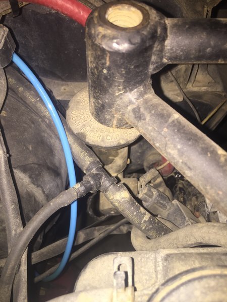

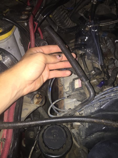

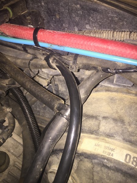

    The vavuum is way different for us than most instructions because we have the power steering vacuum hoses
  18. Aug 2, 2016 at 8:42 AM
    anthony250f
    anthony250f Well-Known Member
    Feb 18, 2012
    #73066
    16,682
    Anthony
    San Diego, CA
    2008 dcsb trd offroad 4wd
    Here is my vsv connection . Both my power steering hose and vsv t off the Evaporate hose by the brake booster. So one of my ps hoses goes across the firewall to meet at the brake booster
    . The other ps hose goes straight into the intake air tubeimage.jpgimage.jpgimage.jpg

    Nice! Thanks a ton. Gaget even sent the pdf of the wiring. I like the vacuum diagram too. Hopefully get this bitch running tonight!
