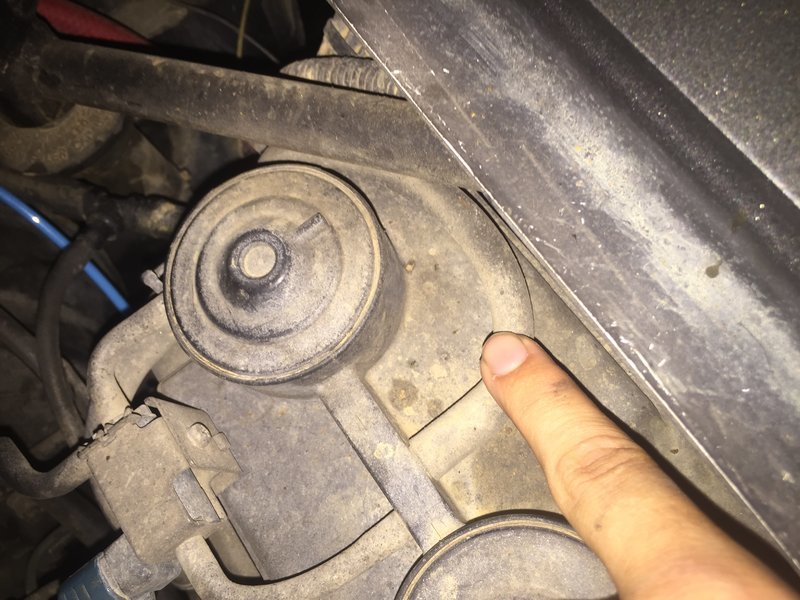

    Did you tie into the purge port on the evap canister?

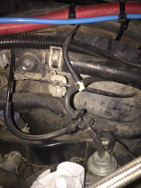

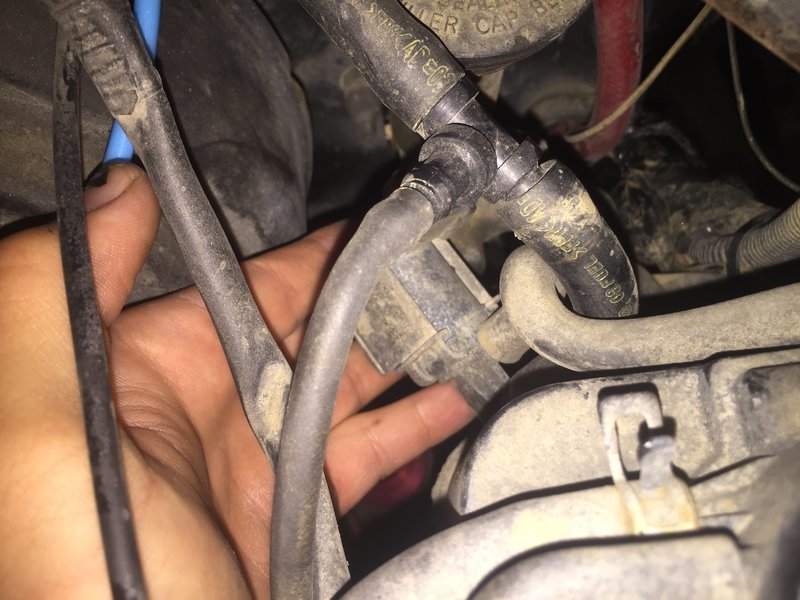

    Idk? It goes here. Is that what that is ??image.jpgimage.jpgimage.jpgimage.jpg
  15. Aug 5, 2016 at 6:10 PM
    anthony250f
    anthony250f Well-Known Member
    Feb 18, 2012
    #73066
    16,780
    Anthony
    San Diego, CA
    2008 dcsb trd offroad 4wd
    It is like a little box with the wire attached to it

    Ah..no bracket here. I made it work.
    Yea. Purge. Cool what I did.

    Cool. Both my ps hose and my 4wd vac t into that line. Both the boost gauge and urd vac line t off the fpr to sc vac hose

    Yea my 4wd goes to the manifold and the high idle and one of the other random vsv.
    Power steering comes off the evap and another vsv up front.
