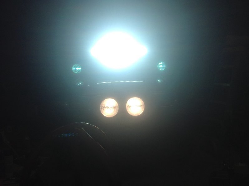

  17. Aug 10, 2016 at 8:33 PM
    Blackdawg
    Blackdawg [OP] Dr. Frankenstein
    Dec 31, 2010
    #48500
    81,638
    Monte
    Wyoming/St. Louis
    The Trifecta of Taco's
    Well. I'm ready to be seen from space again. Or at least almost.
