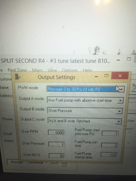

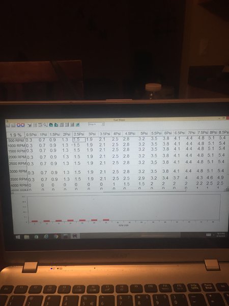

    Fuel map vv
    image.jpg image.jpgtiming map ^^image.jpg and change your over pressure to 1 instead of 4. That way the 7th comes in sooner

    Thanks! And map A is timing yea?
    Think it would be possible for you to upload the direct file?
