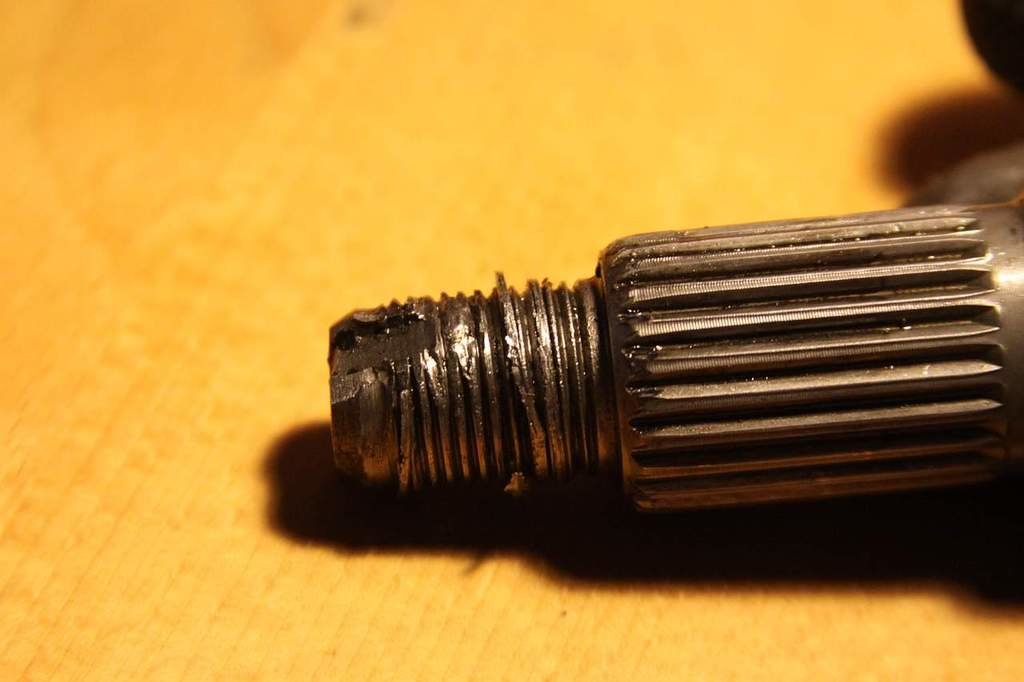

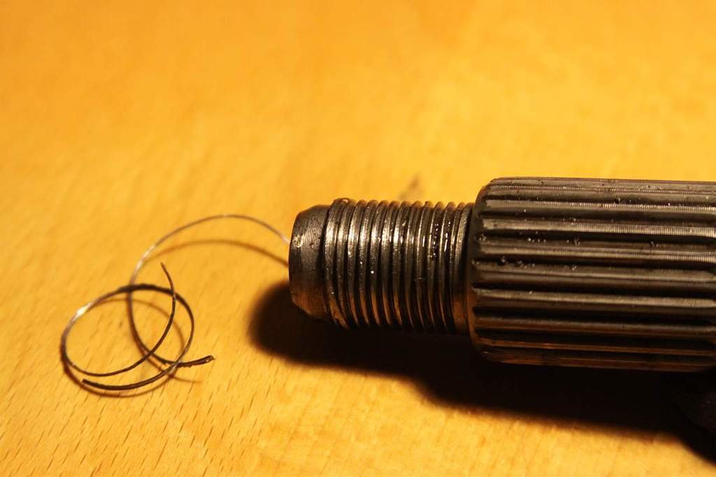

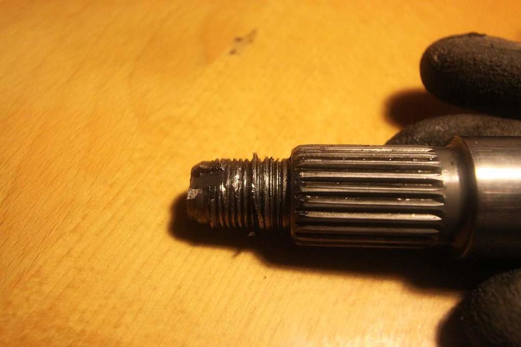

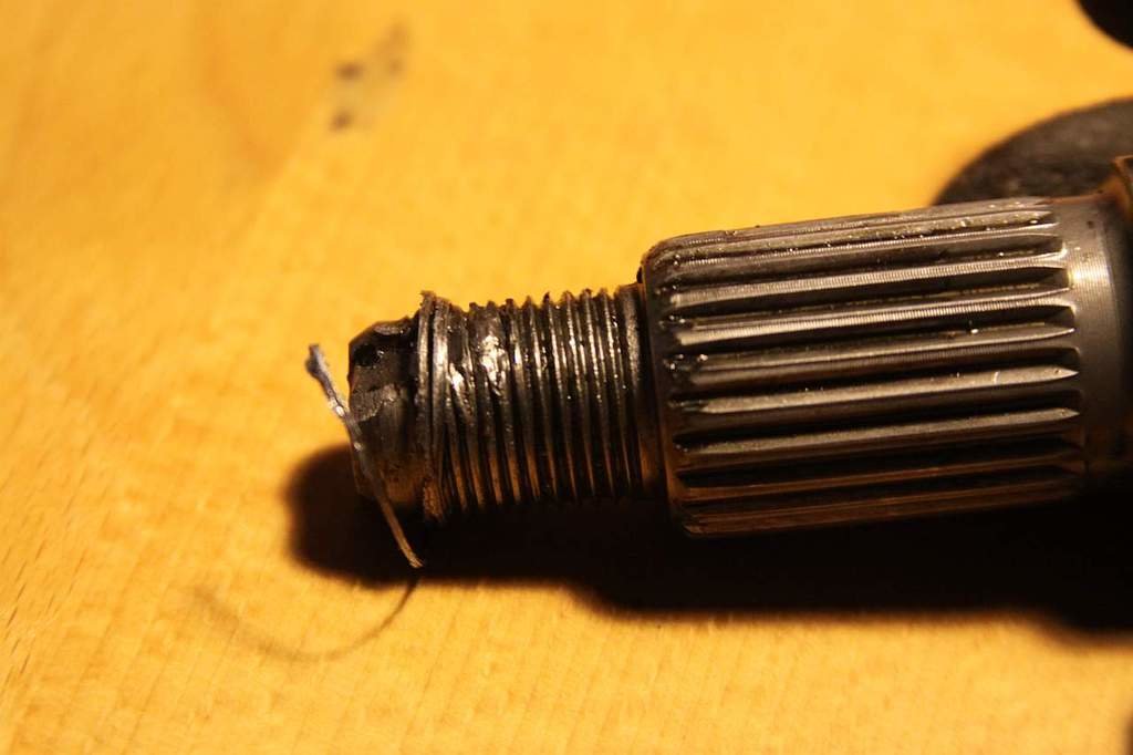

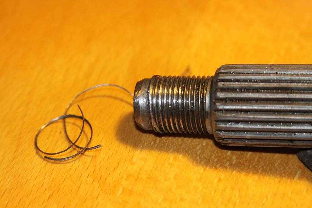

    There are times I wish I had a macro lens. This is one of them.
    Here are some close-up (as close as the lenses would focus) pics of the thread end of Franks failed pinion. I am wondering if somehow that staked nut wasn't pulled/yanked off the end of the pinion? Is that even possible?
    These threads are definitely fubarred
  15. Aug 26, 2016 at 8:03 PM
    Blackdawg
    Blackdawg [OP] Dr. Frankenstein
    Dec 31, 2010
    #48500
    81,638
    Monte
    Wyoming/St. Louis
    The Trifecta of Taco's
    Huh. Interesting. Yes it is possible. Lemme go look at the nut
  16. Aug 26, 2016 at 8:07 PM
    Blackdawg
    Dec 31, 2010
    #48500
    81,638
    Monte
    Wyoming/St. Louis
    Nut is totally stripped. No threads at all. :notsure:
  17. Aug 26, 2016 at 8:11 PM
    Digiratus
    Digiratus Adventurer
    Mar 26, 2010
    #34006
    23,828
    Roaming the PNW
    The RedHead
    2002 XtraCab TRD 4x4 SCv6 AutoTrans With Lots of Mods ADS COs w/Compression Adjusters Camburg Uniball UCAs Whiteline Lower Control Arm Bushings Kartek 7" Limit Straps Plastics Guy Front Bumpstops Total Chaos Sprindle Gussets Custom Alcan Springs +800 lbs +3" ADS 10" Stroke Triple Bypass w/Resi Rear Shocks Custom Rear Shock Relocate All-Pro U-bolt Flip w/Timbren Bumpstops 4.88 Nitro Gears ARB Front Locker ARB Twin Compressor Black 17x8 Konig Countersteer Type X 285/70r17 Falken A/T3w Gunmetal 16x8 SCS Ray10s 255/85r16 Maxxis Bighorns Limited Edition (Relentless) Elite Front Bumper Smittybilt X2O 10K Winch Diode Dynamics SS3 Sport Selective Yellow Fog Lights in the Bumper Diode Dynamics SS3 Pro 4,000 Kelvin SAE Driving Lights with Clear Lenses on the Bumper Morimoto D2S Projectors XB35 Ballasts + 4300K Bulbs Badland Sliders FrankenFab Tire Carrier Swingout bumper w/kitchen BudBuilt Front & Bellypan Skids BAMF Rear Diff Skid Dometic CFX 55im Fridge/Freezer Alpha II Hardshell RTT Badland Custom Bed Rack Denso 210-0461 105 amp alternator Dual Northstar 24F AGM batteries BlueSea 7622 ML-ACR Battery controller Peak DBI Dual Battery Voltage Monitor Haltech IC-7 Display with Mako Dash Insert Haltech Elite 2500 Standalone ECU Magnuson MP62 Supercharger w/URD 2.2" Pulley Doug Thorley Headers Denso 650cc Fuel Injectors Aeromotive Stealth 340 Fuel Pump TransGo A340F Reprogramming Shift Kit OEM ECU Delete Full A340F Trans Control with the Haltech 2500 ECU 2.5" Magnaflow Hi-Flow CAT Magnaflow 18" Muffler w/Vibrant Resonator 13WL Brake Calipers with OEM Rotors & Pads Braided Steel Brake Lines Kenwood TM-71A Dual Band Ham Radio STI-CO Flex Whip VFH/UHF 1/4 Wave Antenna Midland MTX275 GMRS Radio w/Roof Mount Antenna Pioneer DEH-P9400BH HU Alpine Amps & Type R components (F) and coaxials (R) Wet Okole Seat Covers Weathertech Digital Liners Deck Plate Mod 1" Diff Drop Carrier Bearing Drop
    Curiouser and curiouser. Im thinking that the DS yanked the nut right off the pinion shaft. Almost like the shaft was too short.
    I wonder if the slip yoke fully extends.
  18. Aug 26, 2016 at 8:17 PM
    anthony250f
    anthony250f Well-Known Member
    Feb 18, 2012
    #73066
    16,780
    Anthony
    San Diego, CA
    2008 dcsb trd offroad 4wd
    The slip yoke would pull out of the driveshaft
    Chipskip likes this.
  19. Aug 26, 2016 at 8:29 PM
    Blackdawg
    Dec 31, 2010
    #48500
    81,638
    Monte
    Wyoming/St. Louis
    Interesting. Wouldn't think it would need to move that much. Lemme check
  20. Aug 26, 2016 at 8:48 PM
    Blackdawg
    Dec 31, 2010
    #48500
    81,638
    Monte
    Wyoming/St. Louis
    Slip yoke is fine. Moves easy and is greased.
