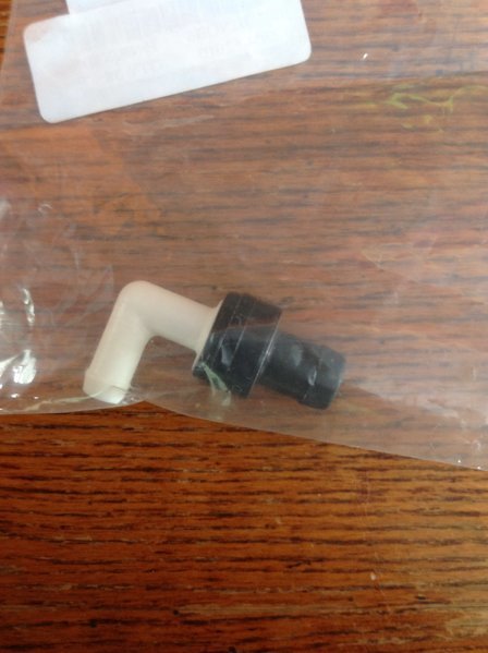

    @SCRunner12 does the black end go towards the throttle body?

    Forgot about that breather. Is that what is causing your issues?

    Probably. It's a check valve for the IAC. just put it in and cleaned the MAF. Runs way better. Doesn't get choked up. Gonna take it for a spin and see what happens.

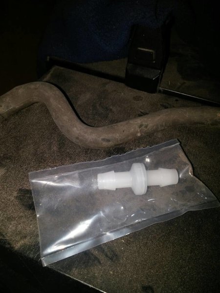

    Uh that's the wrong part...haha. That's a pcv valve, you need the IAC check valve. http://www.toyotapartsdeal.com/oem/toyota~trd~sc~34~check~valv~ptr29-60031.html
    That pcv might work if it only allows air one way but that bend will restrict flow.
    You want the air to flow from the throttle body to the engine. I thought you had it this whole time but that really helps with the higher rpm pulls. I installed mine backwards the first time and it would go dead after 3000 rpm.

    That's the part you told me to get last time. It's a check valve. :notsure: the Trd one is discontinued. No one seems to have it. I'll order it though.

    I was about to say mine looks nothing like that lol
