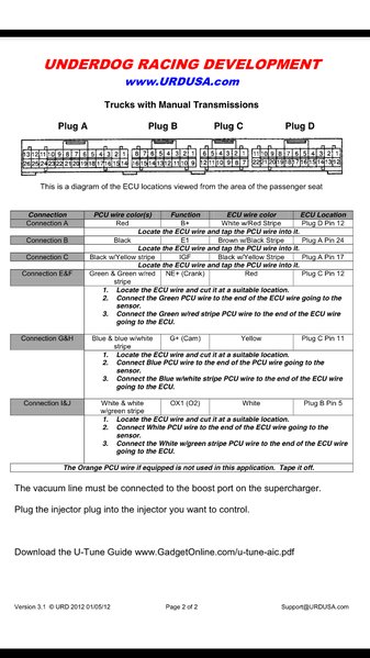

    Im doing some Pin out cross checking, is this photo of the URD wiring for a 97? just want to confirm.
  9. Dec 29, 2016 at 4:56 PM
    anthony250f
    anthony250f Well-Known Member
    Feb 18, 2012
    #73066
    16,759
    Anthony
    San Diego, CA
    2008 dcsb trd offroad 4wd
    Yup!
  10. Dec 29, 2016 at 4:59 PM
    Blackdawg
    Blackdawg [OP] Dr. Frankenstein
    Dec 31, 2010
    #48500
    81,606
    Monte
    Wyoming/St. Louis
    The Trifecta of Taco's
    Okay. Exact same for 96.
