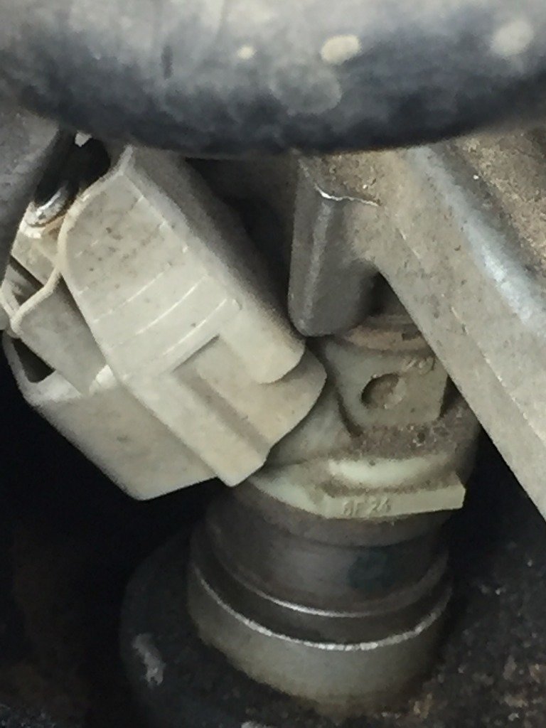

  13. Jul 15, 2017 at 7:41 AM
    Oside7even6ixty
    Oside7even6ixty Well-Known Member
    Jul 15, 2015
    #159531
    337

  15. Jul 16, 2017 at 6:52 AM
    Oside7even6ixty
    Jul 15, 2015
    #159531
    337
    Ya idk bout dealing with tuning on the dd, no experience. Really just want plug an play with minimal work.
    Are there a lot of people who have had issues with the urd kit?
