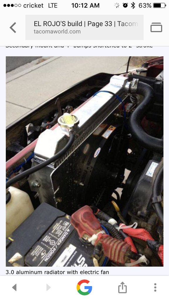

    I was going to text you after work too. I'm running in the mid 200's most likely high 200's now because it's hot out. I haven't put my Engine link reader on yet to check. I should when I get home. With the added plate to the bumper I'm thinking I'm not getting enough air flow from the front. I get home and engine bay is super hot. I'll look into what you suggested too.
    From my understanding there is two radiator's for the first gen. A longer or shorter one in height. I'm running the shorter one. But I don't think I can fit the longer one now because of my bumper.

    I ended up replacing my radiator. Huge difference. My airflow was restricted because of years if mud and gunk build up. Hard to see it and hard to clean it without damaging the fins.

    When I got the radiator I still had the 2.7 at the time. That might be the reason why. I just finished swinging by Tims and with his Scan guage I was 202-206. He says that's fine for the 3.4 But Im really considering the 3 row. I would like to be under 200. Thats where my 2.7 used to run at. I found a cool link. You might like it.
    https://roundforge.com/content/arti...ur-1995-and-earlier-toyota-pickup-or-4runner/

    Put a 170 t stat in it.
    https://www.napaonline.com/en/p/MRD17
    The 3.4 with the smallest (18 5/8") radiator and stock fan, clutch, shroud will still cool just fine. You'll need an external trans cooler with the smaller radiator.
    http://www.rockauto.com/en/catalog/toyota,2002,tacoma,3.4l+v6,1388987,cooling+system,radiator,2172
    There are 3 different sizes that toyota put in 1st gen, 18 5/8, 20.75, and 22 5/8
