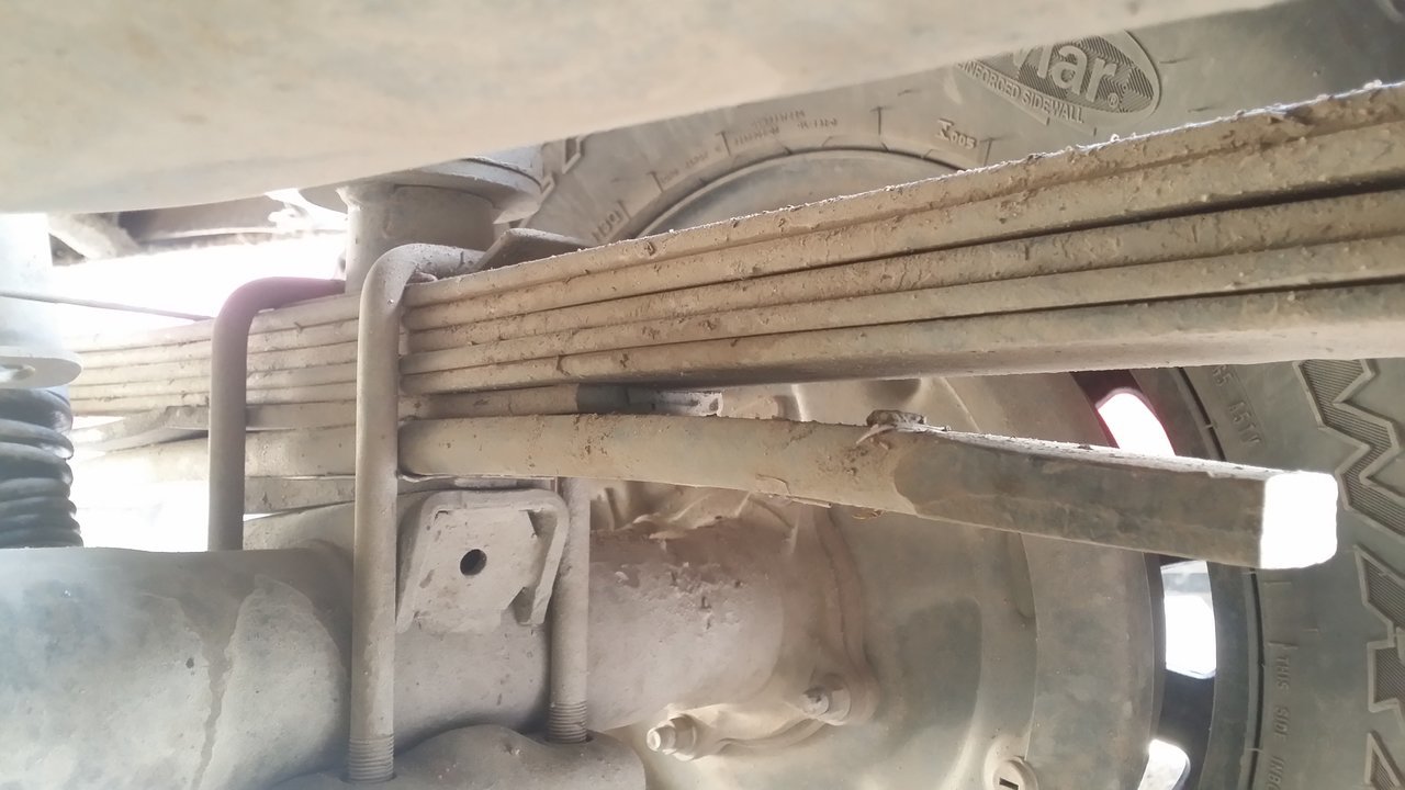

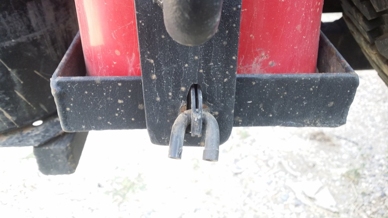

    Got my paranoid fab click switch bracket today for the locker switches. Thanks man! @paranoid56 also picked up a wrench for my scepter gas can from him. No more stuck closed lid for me
    Also this happened..
    Damn.
    And this
    Not cut. Looks like it got rusty and my driving did the rest. Ha.
    Need to redo the gas can holder to fit my scepter can next. Also re thinking the bed rack...again. need it 2.5" taller to fit my military cases to suit my packing setup. Hoping I won't feel the tippiness come back going that tall again and with the heavier rtt. Igor leans fairly hard and the last thing I need is frank to start leaning. So probably going to swap the relentless bed bars over to test it out.

    ARMOR
    Dang that sucks... The only Tacomas I've seen that happen to have been from 96. Something to do with having a shorter leafs than later models or so I've heard

    Huh. I've never heard that. But I can believe it. My third time I've broken leafs.
    Wish I was in a position to start caging and 4 linking...someday.

    It became starkly apparent that you can't have a rig do both the things we like to do well after I dropped the weight off my truck and went on that desert run. Sure an expo heavy rig can go fast but it's not anything like being light and not cringing when hitting something lol. Trade offs I suppose but dang is it gonna be hard to go back. I never realized how heavy I was till it came off.

    Yea here are the leafs of a 96 from our run around Calico.. I'll let you know how that 4-link thing works out for me...

    yeah its really why in a perfect world, id make igor more of the "pig" truck for long trips and mediocore roads and such. I'd love to strip out Frank, slap a LS in it and 4 link him and just have a truck for going fast haha
    Even now, the steering feels really heavy on Frank compared to Igor. But man i can drive a LOT fast in Frank than Igor. Big tires and suspension do pay off and help.
    Not surprised though in your findings. It would be curious to take more of a backpackers approach to it all. May not be as comfortable, but could pay off in dividends in other ways.
    Shit his leafs look Shot as it is..haha
    Yeah i'll be curious to see how it pans out for you for the exact reason Marc brought up...weight. And i know you pack the truck full to the brim and do not run light at all. Be interesting to see how the coilovers cope with it all.

    As for leafs... I can't tell if the leafs broke in the front for both of you... but, I suspect they did. My '96 leafs were way shorter in front than out back which made them bend a lot more when the suspension moved. It makes me think about that discussion we had years ago about negative arch and whether it would shorten the life of leaf springs...

    That's a good point. They are very short. My two main leafs are looking pretty bad as well on the front half. Really wish I could go 4 link and not bother with a new leaf pack that I can't swap over to my other truck when I'm done.
