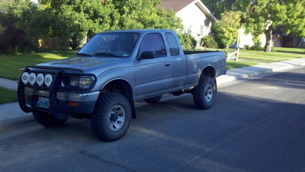

    As some know, i literally nuked my front diff a while ago. Haven't had time or money to fix it...UNTIL NOW!
    Ordered an ECGS front with 5.29s, solid spacer, bearing upgrade and of course an ARB locker :cool:
    Takes a lot of diffs to fix frank..
    [​IMG]Front Locker.jpg by Monte Nickles Photos, on Flickr
    One is my nuked one. One is the new one. And one is donated by @joshipps as ...well its also nuked. But less nuked then mine in that the housing isn't cracked in 3 places so i can send it in for a core to ECGS. Thanks buddy! :cheers:
    This isn't much of a write up..already done that. BUT here is the photos i wish i had taken last time for people. How to remove the stub shaft.
    [​IMG]Front Locker-4.jpg by Monte Nickles Photos, on Flickr
    This is how you pop it out. Takes more force then you want to use.
    [​IMG]Front Locker-5.jpg by Monte Nickles Photos, on Flickr
    Ta Da!
    [​IMG]Front Locker-6.jpg by Monte Nickles Photos, on Flickr
    Here is the bearing upgrade. OEM needle Bearing bushing.
    [​IMG]Front Locker-7.jpg by Monte Nickles Photos, on Flickr
    ECGS Bushing.
    [​IMG]Front Locker-8.jpg by Monte Nickles Photos, on Flickr
    Not sure i needed it..but what the hell!
    Put the stub shaft back in the new diff.
    [​IMG]Front Locker-9.jpg by Monte Nickles Photos, on Flickr
    Also transfered my super custom drain plug haha
    [​IMG]Front Locker-10.jpg by Monte Nickles Photos, on Flickr
    All done!
    [​IMG]Front Locker-11.jpg by Monte Nickles Photos, on Flickr
    Now to run the air line. I ran the blue line through some thick rubber fuel line to protect it from heat and other things trying to cut it.
    [​IMG]Front Locker-12.jpg by Monte Nickles Photos, on Flickr
    Then i ran it to the back of my cab.
    [​IMG]Front Locker-22.jpg by Monte Nickles Photos, on Flickr
    [​IMG]Front Locker-17.jpg by Monte Nickles Photos, on Flickr
    [​IMG]Front Locker-18.jpg by Monte Nickles Photos, on Flickr
    [​IMG]Front Locker-19.jpg by Monte Nickles Photos, on Flickr
    [​IMG]Front Locker-20.jpg by Monte Nickles Photos, on Flickr
    [​IMG]Front Locker-21.jpg by Monte Nickles Photos, on Flickr
    Then i started my redo on wiring and air routs for the CO2.
    Started with a Paranoid Fab Clock bracket. @paranoid56 thing fits perfect and works great, as usual. Thank you sir!
    sprayed it with some bed liner i had lying around.
    [​IMG]Front Locker-23.jpg by Monte Nickles Photos, on Flickr
    Waited a long time to see two of these in my truck..
    [​IMG]Front Locker-24.jpg by Monte Nickles Photos, on Flickr
    Did the wiring so they actually light up this time.
    [​IMG]Front Locker-25.jpg by Monte Nickles Photos, on Flickr
    Perfect fit!
    [​IMG]Front Locker-26.jpg by Monte Nickles Photos, on Flickr
    [​IMG]Front Locker-27.jpg by Monte Nickles Photos, on Flickr
    :woot:
    [​IMG]Front Locker-28.jpg by Monte Nickles Photos, on Flickr
    Then i decided to move my CO2 bottle so it would be easier to turn on when i needed it to the cab. I built a small manifold as well.
    this was v1
    [​IMG]Front Locker-2.jpg by Monte Nickles Photos, on Flickr
    [​IMG]Front Locker-3.jpg by Monte Nickles Photos, on Flickr
    Which almost worked perfect. But didn't line up right.
    So i ended up with this.
    [​IMG]Front Locker-15.jpg by Monte Nickles Photos, on Flickr
    Not bad.
    [​IMG]Front Locker-16.jpg by Monte Nickles Photos, on Flickr
    Screwed the mount to my sub box and had all the wires and air line right there at the back of the cab. It'll work for now until i can redo the whole sub/rear seating area.
    Haven't tested it yet as Frank's leafs are getting a slight refresh with a new AAL as i cracked the last one(again) in half..in 3 places. Plus all my bushings were shot.
    Going to do that tonight and tomorrow!
    After this. Think i'll spring for a Meth setup for the blower.
    Maybe..not sure.
