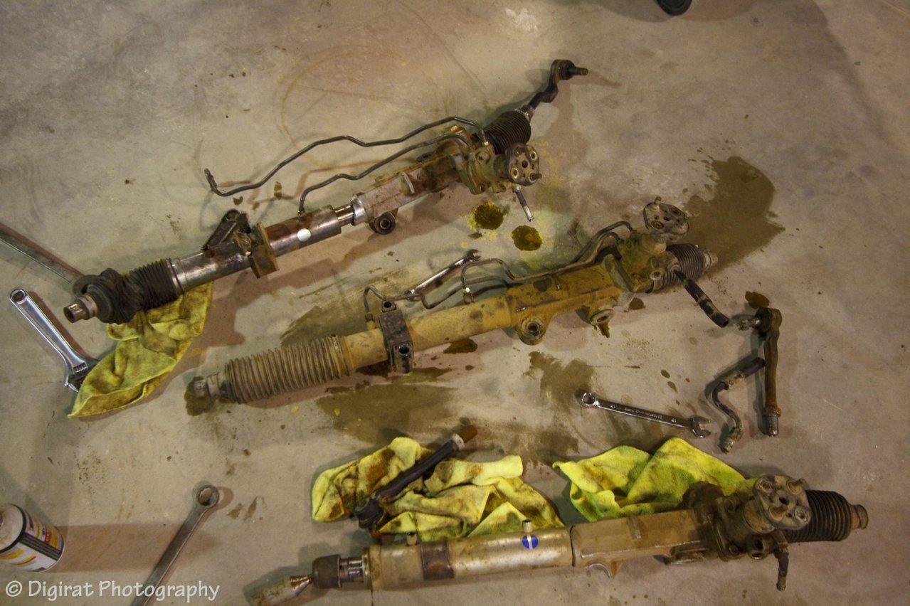

    Have you fubar'd the steering rack during any of those failures?
  18. Apr 25, 2019 at 5:20 PM
    Blackdawg
    Blackdawg [OP] Dr. Frankenstein
    Dec 31, 2010
    #48500
    81,641
    Monte
    Wyoming/St. Louis
    The Trifecta of Taco's
    Oh yeah.
    Split two in half.
    On my third one.
    Probably put in a brand new one soon

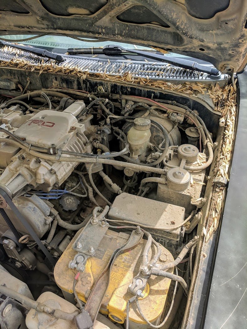

    Obviously it has been a long ass time since Frank has....well done anything. He's barely moved in a year and a half since his last ball joint mishap.
    My new DD SX single cab's motor mounts were bad. And I have had some @Bonzen motor mounts and a tranny mounts sitting on the shelf for a long time. Seemed like a good reason to get them swapped in so i could reuse the TG Bombproof ones and 4xinnovation tranny mount on the SX. So I headed down to Wyo to revive Frank.

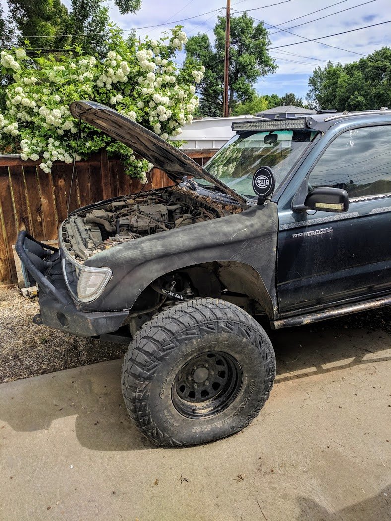

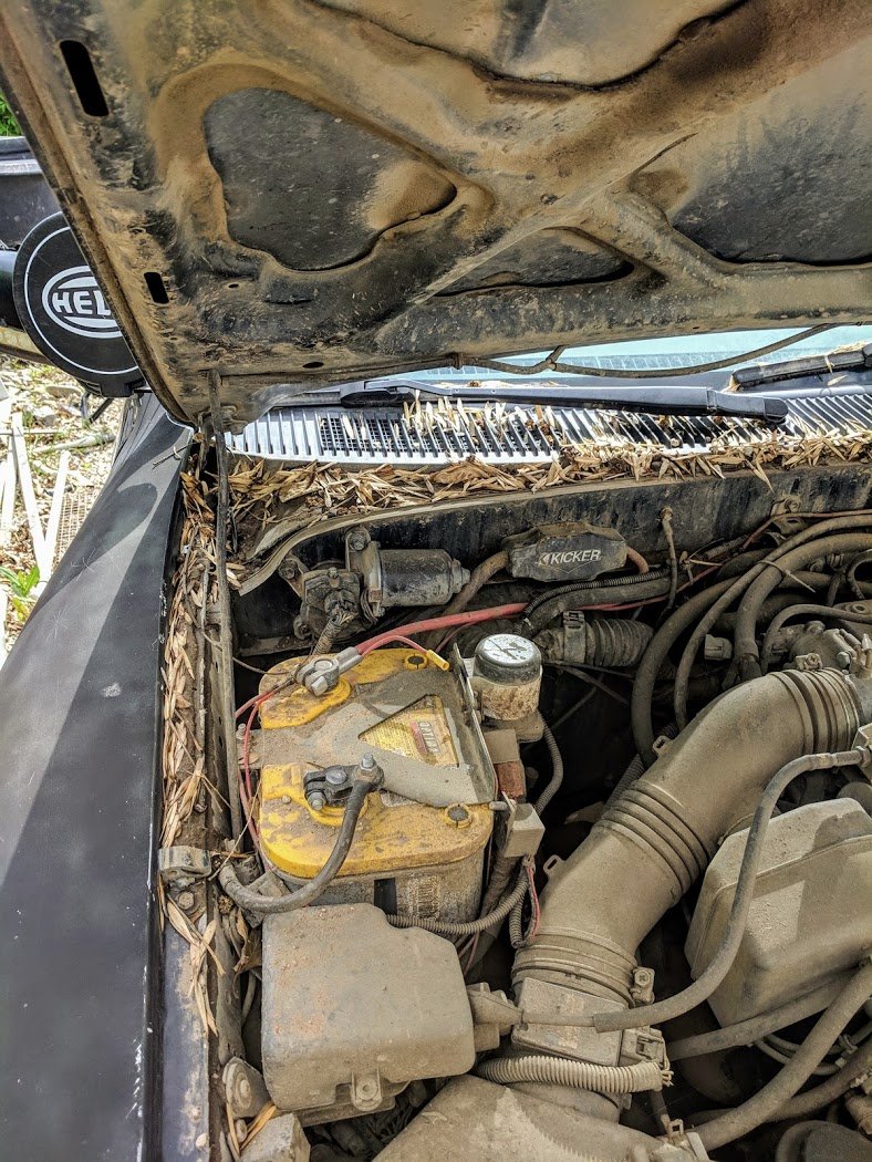

    He didn't look great...but considering he's been outside basically his whole life, wasn't bad! Needed a good wash.
    I apologize, I did not have my camera with me, just my phone. Doesn't take horrid photos though..
    Every tire was flat, one had no air at all in it.
    Batteries were toast as well. Should have pulled them but I know if I'd had done that my Dad would have stolen them for some crazy HAM radio shit..one was brand new though so should be able to get that one replaced. The only is actually pretty old so..meh.
    Anyways jumped him and took him to the car wash before pulling in to the shop.

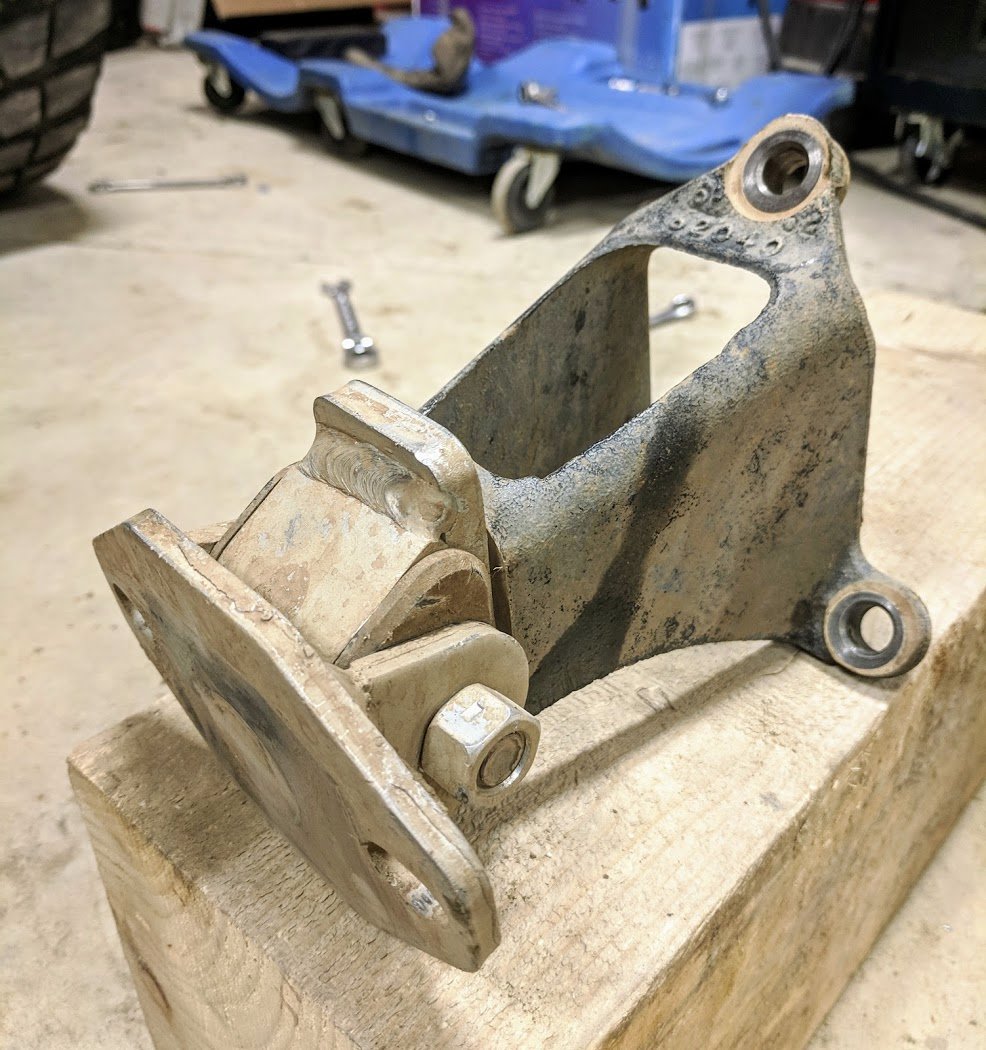

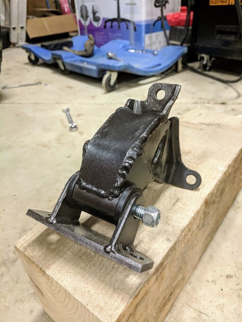

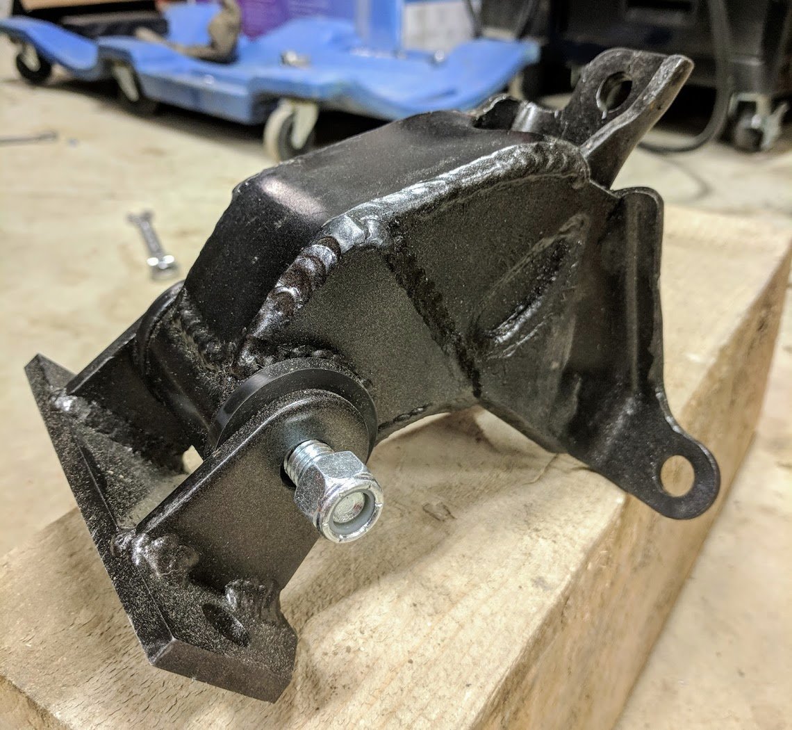

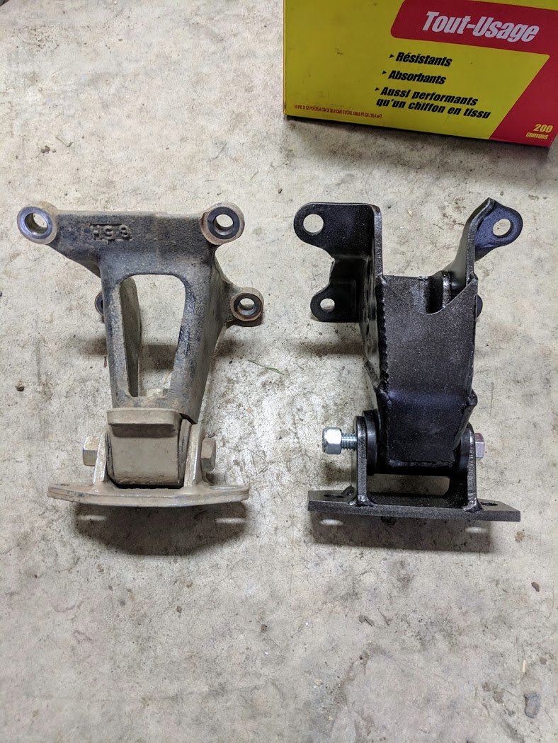

    I started with the motor mounts as I knew those would be the biggest pain to do. The new Bonzen mounts were pretty beefy, not only new mounts but also new block mounts!
    AKA...even a bigger pita to install from when I did the TG ones. And wow was it ever. I had to pull the starter and the AC compressor bracket off to get the old ones off...
    But finally did!

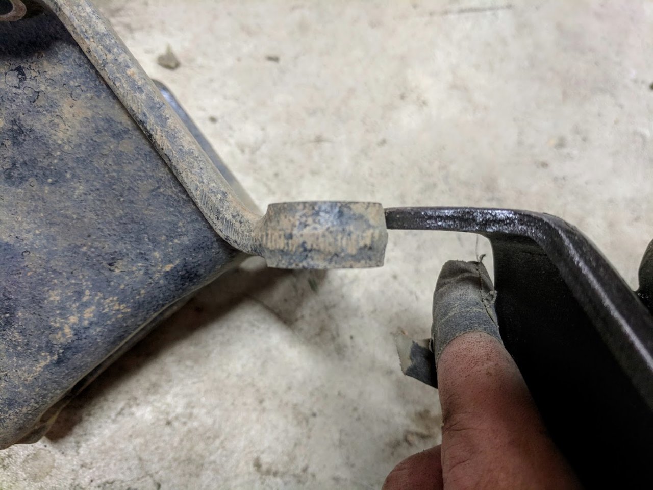

    You'll notice the block mounts are different. The 95-97/98s used Cast iron mounts vs stamped steel ones. Bonzen uses the stamped steel ones as his base and likes it when you can send your stock ones back afterwords, but has no use for the Iron ones.

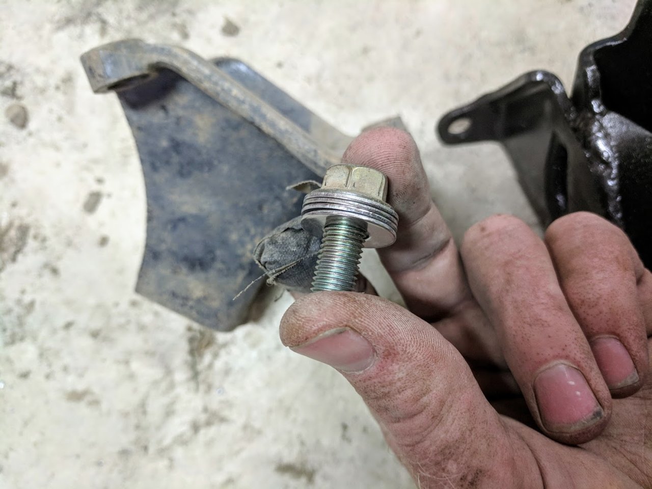

    Due to the difference there were some complications...mainly this.
    I had forgetten about this. I knew about it when I bought them but forgot until now...of course.
    The right course of action would be to get later year bolts that aren't as long, aside from one. The one where the AC compressor bracket shares a motor mount bolt..that should be a steel spacer. Sadly, I didn't have this or the time to do. So..
    This will have to do for now.

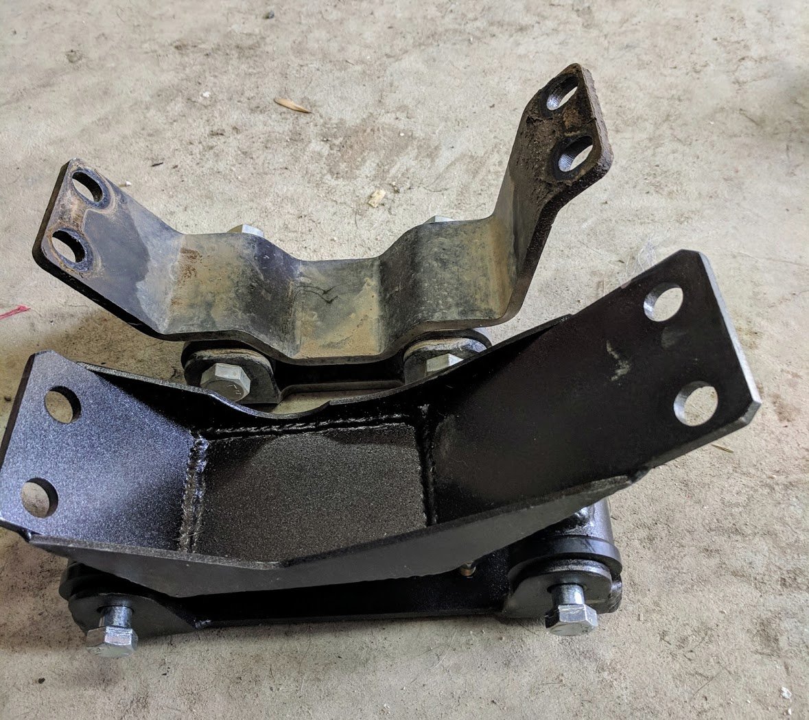

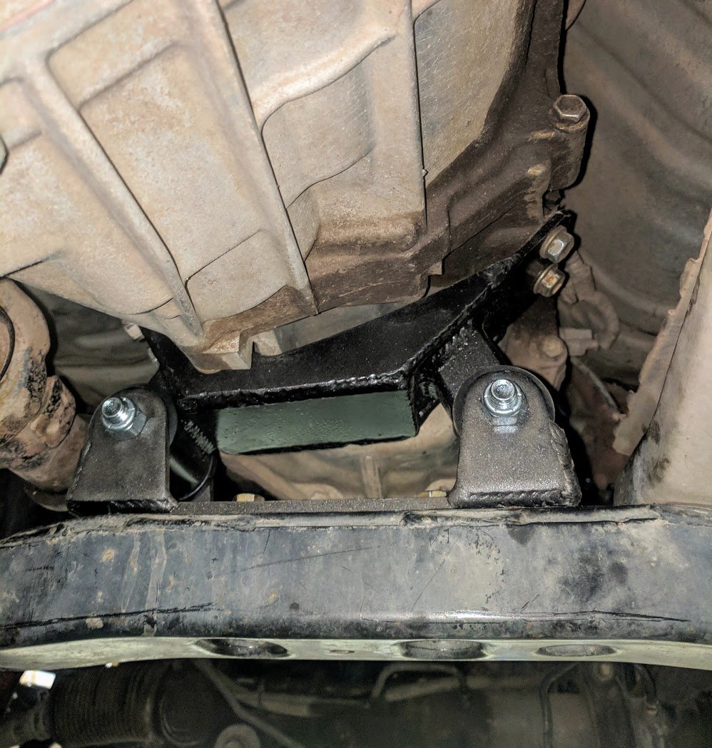

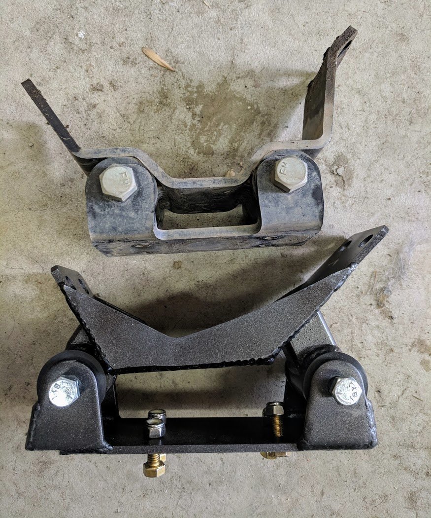

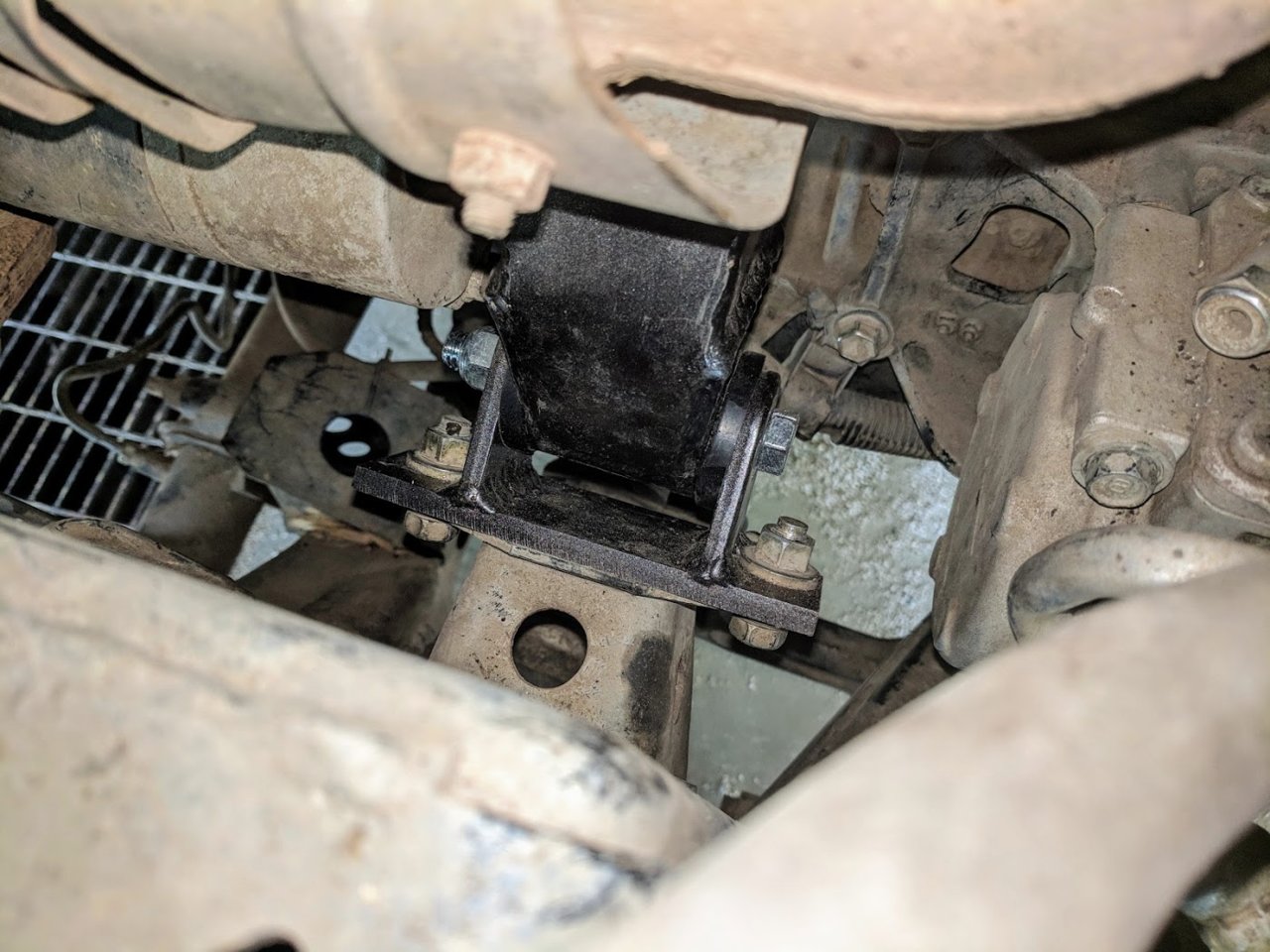

    Next was the transmission mount. The 4xi came out super easy.
    Honestly the 4xinnovations one is pretty nice as its all 1/4'' steel. I just wanted shit to match more than anything :anonymous:
    The Bonzen mount went in though pro tip...install it from the front side not the back like I did. Will go in much better, my jack was just in the way.
