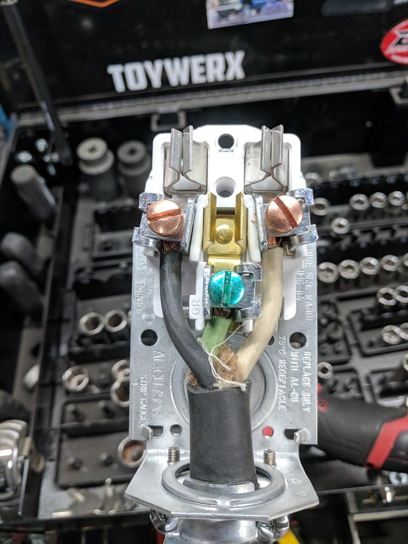

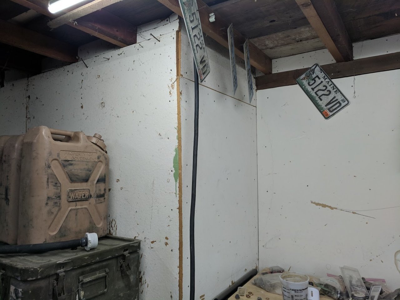

    No super build related...but still pretty damn important.
    Ran 55' of 8ga wire from my laundry room up into the attic and over to the garage. Was glad I ordered the extra 5' and wish I'd just gotten 60' but still have plenty of cable to get around my tiny ass space.
    Forgot I needed a Male plug but got it wired up other than that. Be so great to be able to weld again.
    Cable come from the attic ha

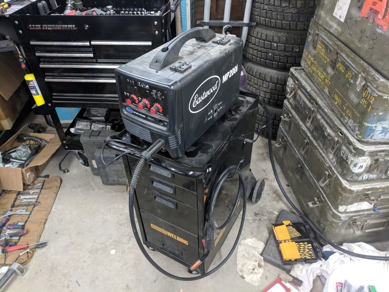

    And the welder I'm borrowing from my dad. I've used it before and works quite well.

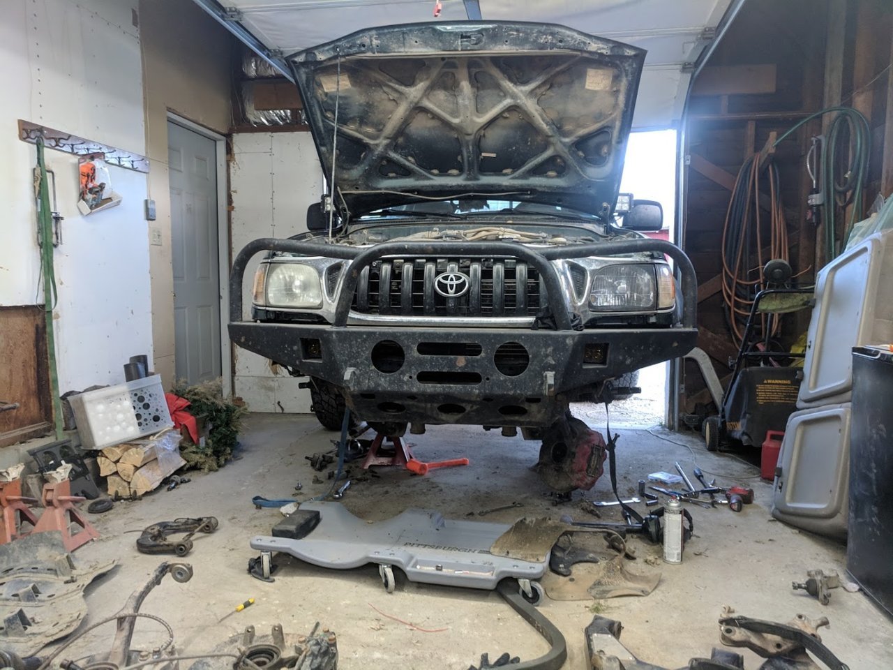

    The shop is a mess from other projects and this big one.
    8W2ovVzqj3ta_bv37_xE1Xh-eUmegxIM1gEjplrh_efabc9f05ccee8ea47ed553cab9f2082a7dc56ab.jpg
    mSnNI5RgvnXtKgEGw6mwjIq08zTY2P_n4MsWSSnB_90c4bcdd8fe77fa1dccda3b94eb0f9d52f5f0424.jpg
    JEctXTmk_filnfQR4_IlQyUCxx5mMGzAKMsSyvMU_2851c330027aa59eb3343032fbf77a86edc2f41d.jpg
    Still, getting there.
    Need to get a 10mm flare wrench...which i don't know why I don't have or just can't find to get the driver brake line off. Open end wrench wasn't quite doing it and don't wanna fuck it up.
    After that I'll do the spindle gussets while I wait for bushings.
