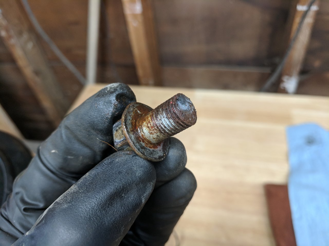

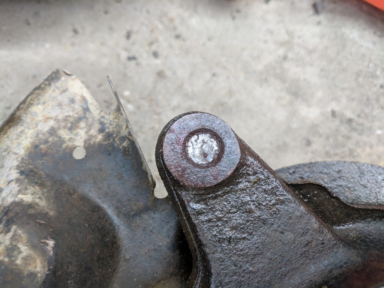

  11. Jun 15, 2020 at 7:24 PM
    Blackdawg
    Blackdawg [OP] Dr. Frankenstein
    Dec 31, 2010
    #48500
    81,606
    Monte
    Wyoming/St. Louis
    The Trifecta of Taco's
    God damn it.
    I miss Wyoming and it's untreated roads..
    Did I ever mention when I pulled the lt kit off of Frank I had never applied anti seize and the cam tabs cam apart basically by hand. Wtf.

  14. Jun 16, 2020 at 12:58 PM
    Dalandser
    Dalandser ¡Me Gustan Las Tacos-mas!
    Feb 19, 2015
    #149090
    17,610
    Anthony
    Downey
    08 PreRunner Regular Cab / 98 4x4 Extra Cab
    Empty Wallet Mod
    I’ve gotten some old rusty crusty used ones out with plenty of penetrating oil and a screw driver to punch them out by the inner lip.

  16. Jun 17, 2020 at 8:48 AM
    Blackdawg
    Dec 31, 2010
    #48500
    81,606
    Monte
    Wyoming/St. Louis
    Still battling it. I've drilled out as much as I can before getting into threads. But if this doesn't work which I'm doubtful it will I'm going to try some welding tactics.
  17. Jun 17, 2020 at 8:58 AM
    cynicalrider
    cynicalrider #NFG
    Jul 25, 2012
    #83399
    17,128
    Jersey
    01 SR5 TRD 4x4, '23 Bronco Wildtrak, 2017 HSQV FE350
    Drop bracket lift and booger welds
    I don't even fuck with trying to drill shit out anymore after I have see so many successes with welding. The heat just blows away all the corrosion and the shit pops right out. Not sure what the back side of the spindle look like but if you can get a big ass nut on it and fill the middle, making sure the weld pool doesn't hit the spindle is your best bet. Or even a smaller nut that fits inside the bolt material.
    I removed stainless bolts that fused to aluminum just this morning.
    Wishbone Runner likes this.
  18. Jun 17, 2020 at 9:19 AM
    Blackdawg
    Dec 31, 2010
    #48500
    81,606
    Monte
    Wyoming/St. Louis
    yeah I've done that on my front diff bolt. Welded a big ass nut to it. Will try this out tonight.
    I have the other side with the new slug in it and prepped for spindle gussets.
