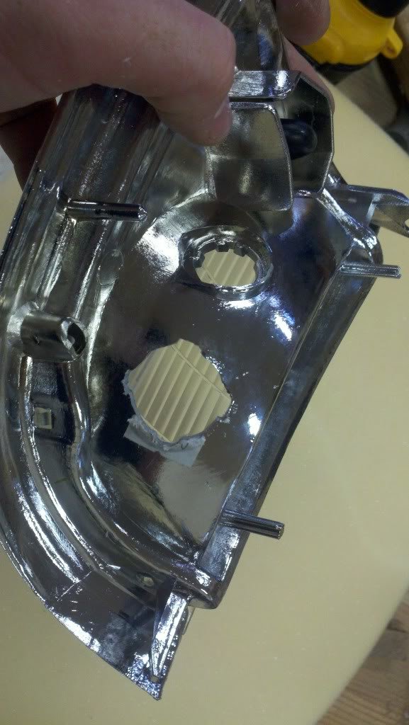

    Since i added the plate bumper i no longer had the place for my stock blinker lights. Those are kinda important haha Some ppl rewire the marker lights that are already in the corner lights to become blinkers.(that light goes in the hole on the left) I didn't feel like doing any rewiring so i simply drilled another hole a bit farther down on the corner light(hole on the right) then took some files too it to cut the approriate notches in it to fit the stock blinker bulb in it at the same time as the marker light. So there are literally two bulbs in my corner lights now. But i didn't have to rewire anything. Not an easy mod, you have to be careful not to break the lights and you have to be exactly right with the hole size for a tight seal, but it works great.
    I am planning on doing a write up on this if i can ever locate some clear corners that fit my truck.
    heres another pic from another set i did.
