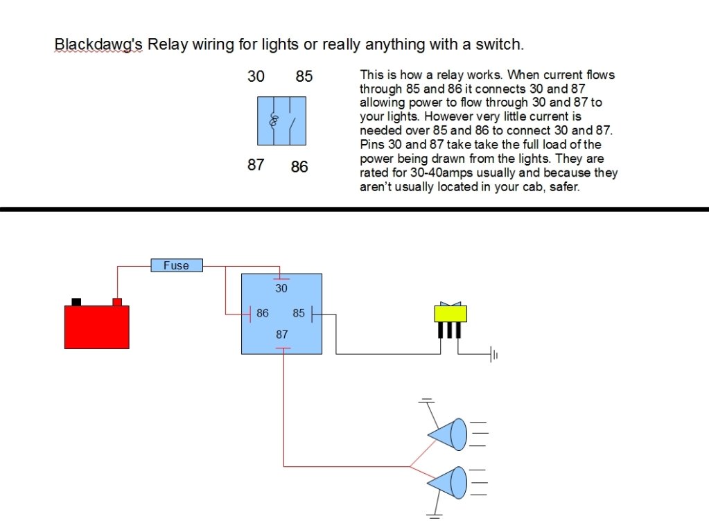

    I've never wired anything up before accept LED strips inside a cab once but that I hooked to the fuse box inside, do you have a link on here of a relay that someone has hooked anything up to

    This is how I wire my relays

    Can I ask a dumb question?
    wtf is that blue box with 30, 87, 85, and 86 in it? The fuse box? :confused:

    Lol no the relay. The numbers correspond to the pins on a 4 post relay. And really a 5 pin but there is an 87a and 87b

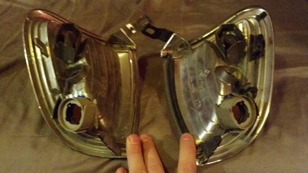

    I'm going to order another set of blinker housings so I can do this with my 03 by cutting up the blinker housing the way you're supposed to do it with 01-04. Then somehow put so HIDs in my old blinker housing!

    did this today with an extra set of blinker housings I picked up from a local guy on craigslist today
    I ordered some cheap big LED bulbs and sockets that i'm going to wire into the old blinker housings.
