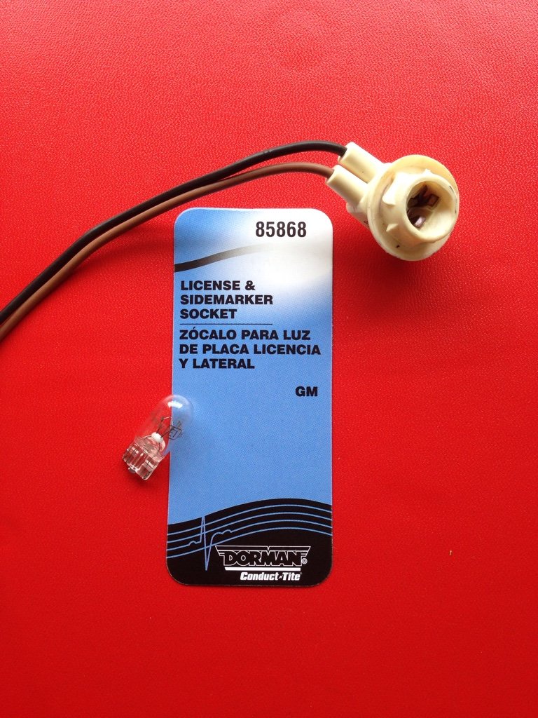

    I don't know. I can't remember and I can't find the package they were in. I went to two parts house to find them. I went to the section that has the little harness and got one. Then looked at all the bulbs to find the most wattage that wasn't bigger than the fixture itself. But you could actually go a little bigger than that because of the notches cut into the housing. Know what I'm saying?

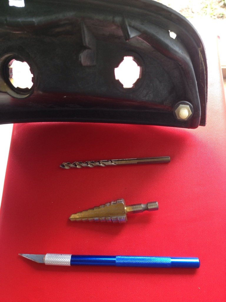

    Just an FYI anybody trying to do this, heating up a 1" pole works a lot better than the drill. Then you just dremel the notches and make the hole a little bigger
    Edit: credit to Monte for that, I just forgot to type that :facepalm:

    I started to drill and it was taking forever to start so I found a 1" pole heated it up and bam. Didn't have a dremel so I used the drill bit so it looks like shit, but functional :thumbsup:
