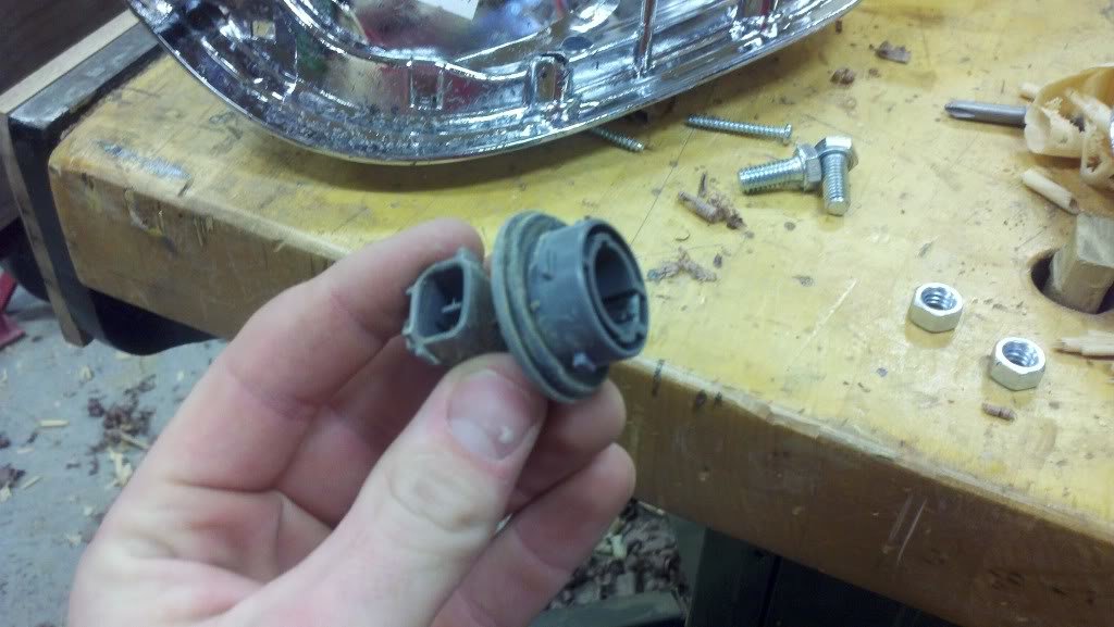

    Hey Monte... any idea what the part number for this part is? (I might actually get around to doing the blinker relocation mod!)

    Hmmm I don't. I will look once I get to a computer though!
