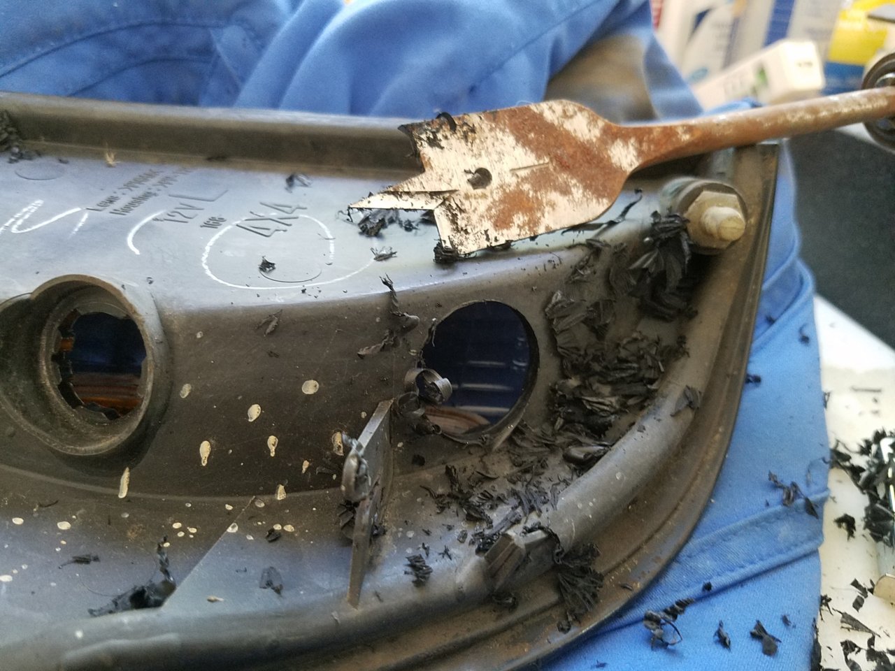

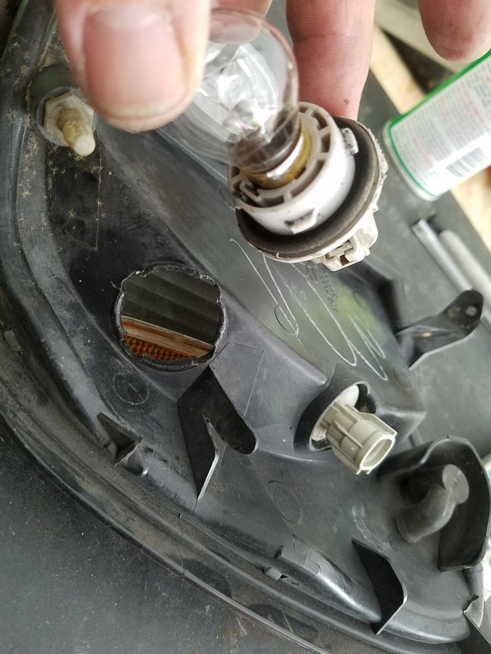

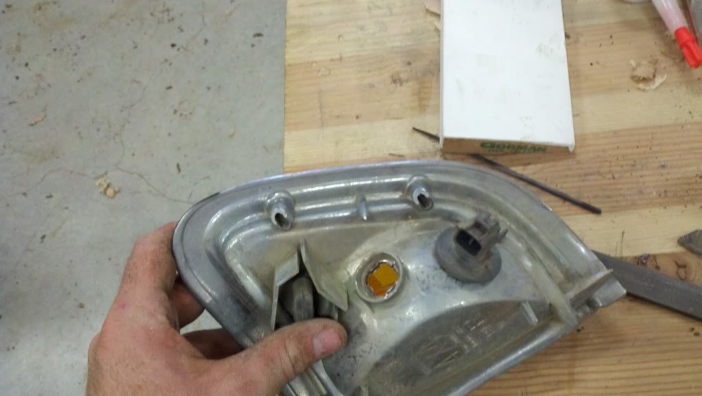

    On my 2000 I used a 1" pipe on one side and it did pretty good. On the 2nd one I used a 1" spade drill(for wood) and it worked a little better because it didnt leave any melted plastic. In full disclosure, I've been a machinist for 26 years and have drilled many, many holes. If your good with a drill, then IMO the drill is a little better. The drill did leave the hole a little undersized and I ended up using the pipe on the hole I drilled to open it up a little. The hole needs to be at least 1.025". I used a dremel for the slots. I also had to grind down the outside of the connector so it wouldn't hit the light housing.
    I used a vacuum in one hole while blowing air through the other worked awesome to get all the plastic particles out of the housing.
    The bulb is pretty close to the lense. Are folks having any issues with incandescent bulbs(if I dont do led)?

    I never had issues with the halogen bulbs. LEDs won't be either. it's a tight fit for sure. More so on the later years than the earlier ones. On the later years the method of cutting a hole and then cutting the mount off the blinker and expoying it on is a bit better due to that.

    Ok, thanks. The later would set the bulb further away from the lense but I do like the method I did.... I can still do the cut and epoxy if I want to to recess the bulb.

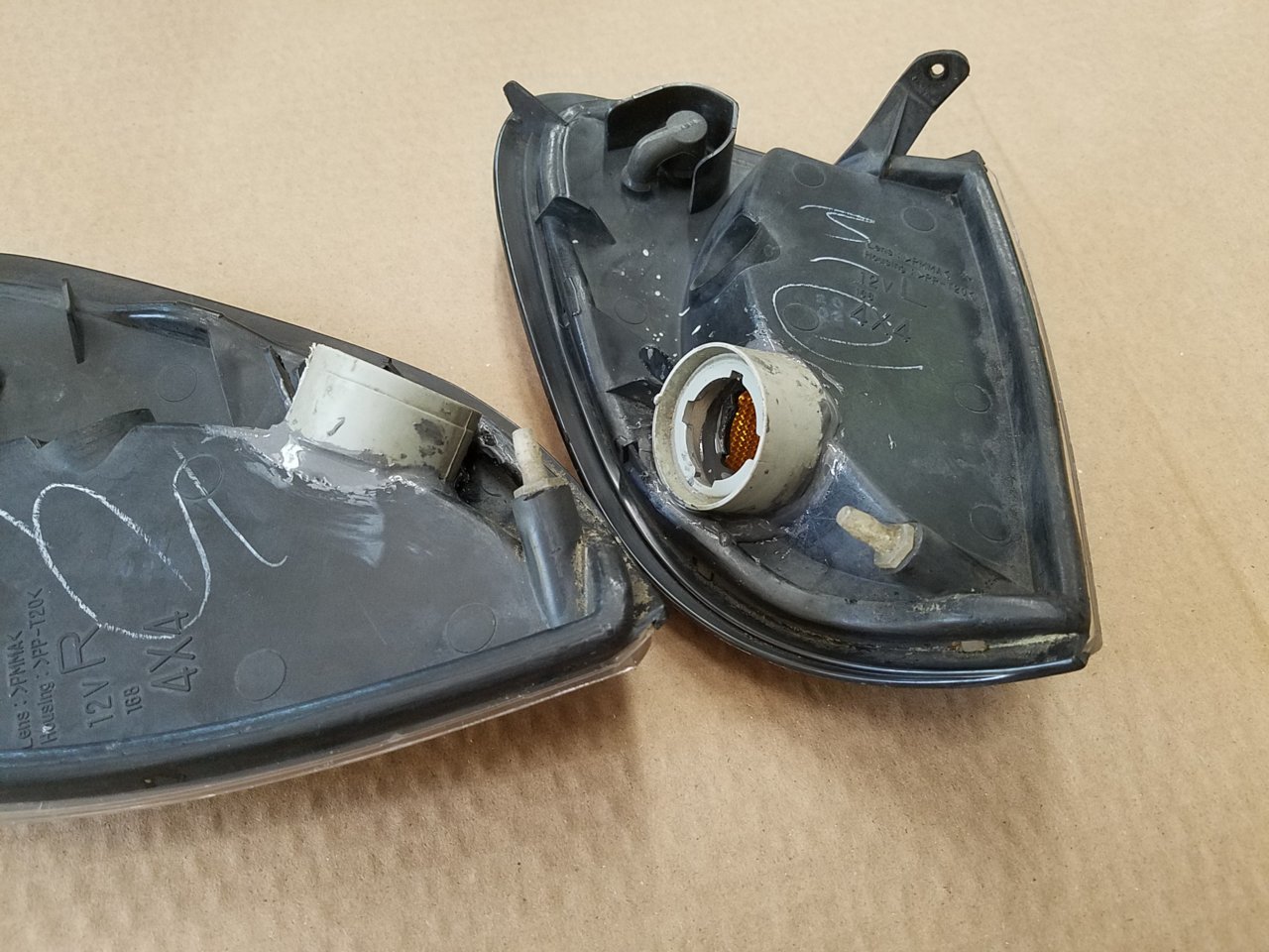

    I decided to cut and epoxy in order to recess the bulbs a little more. Yes, I have issues. :)20200502_093346.jpg
