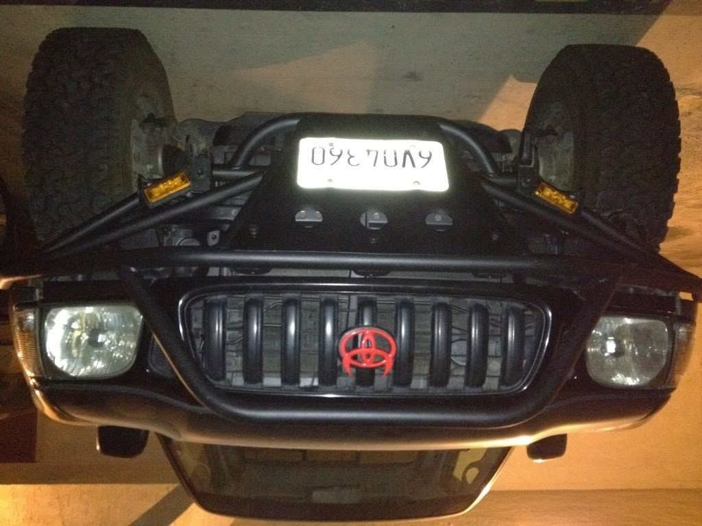

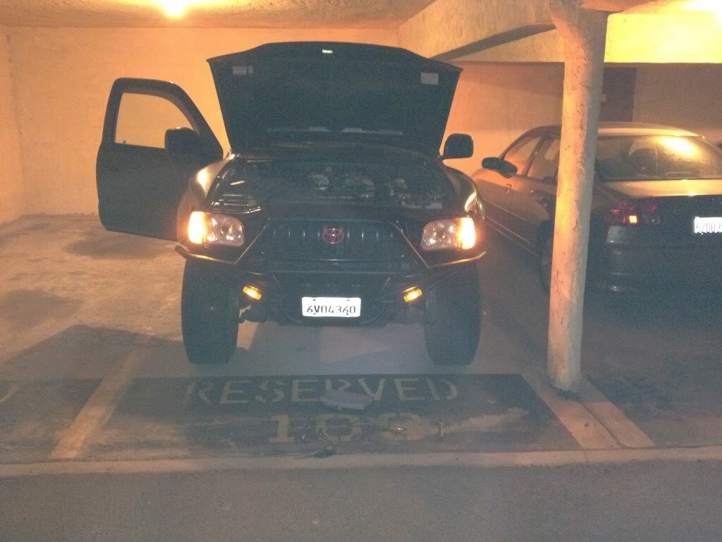

    Well my Truck has been collecting dust waiting for a new transmission, & I decided that I should be doing SOMETHING for my ride so I pulled the trigger on this tonight......;)
    Besides might as well take advantage of the down time & do some simple ,straight forward MODS that I probably would put off if my truck was running.
    & it keeps me interested,involved & still in the loop so to speak....
    I'll put up some more pics after I get some dinner,
    I love this MOD Monte !!! :thumbsup::thumbsup::thumbsup:

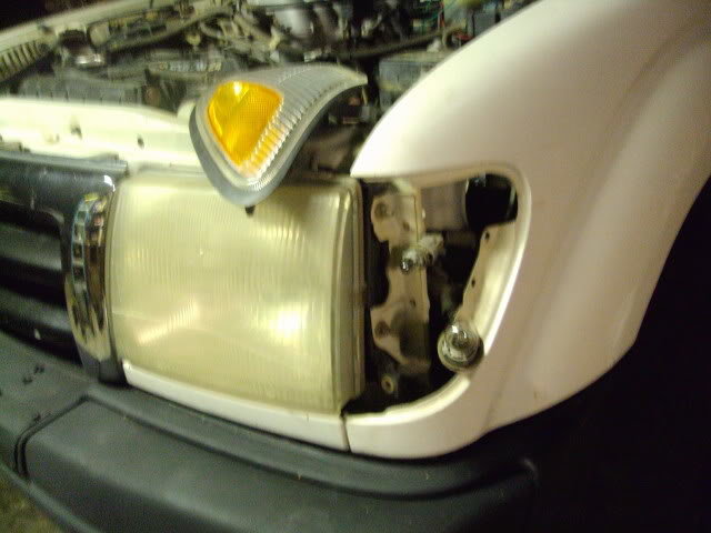

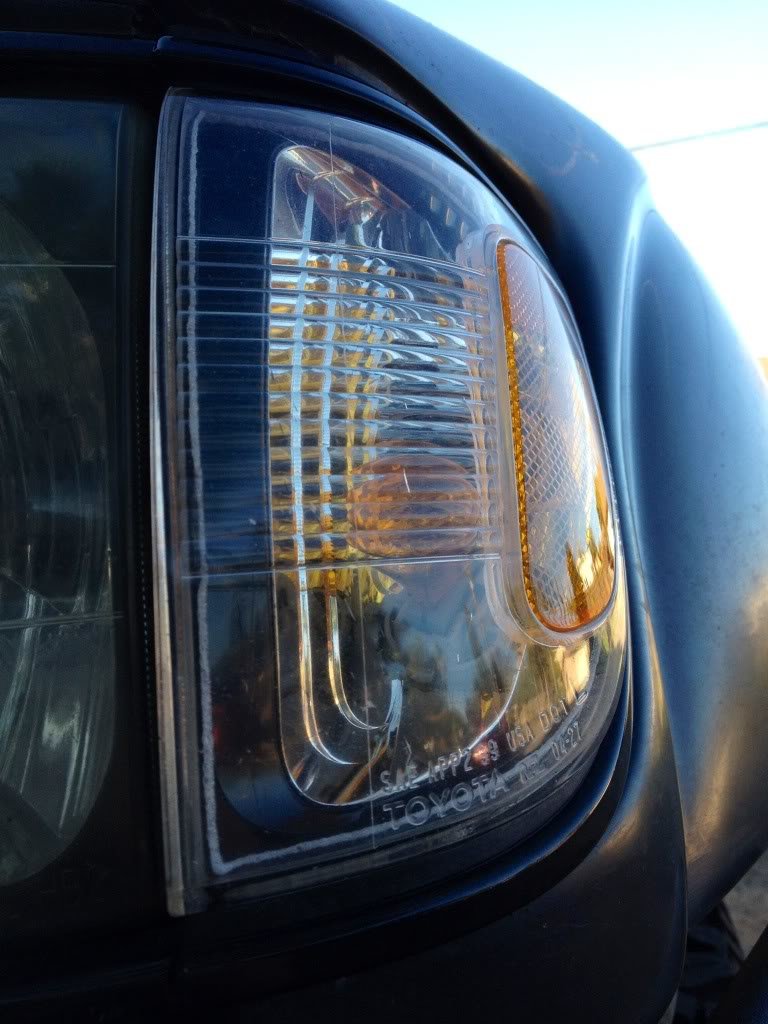

    Did you end up capping the original corner light hole in the housing? If so, with what?

    The marker light hole? No, you leave the stock hole in it, you need it to mount the marker light.
    There will be two holes, One for the stock smaller marker bulb. And then the new hole that you make for the larger blinker bulb.

    Oh okay.. so you put back the marker light after relocating the blinker light, and have two bulbs in each of the corner housings?
    Just want to make sure.
    It's a bit confusing in the 1st post because it looks like you bought new corner housings (that had a plug for the marker light hole) and then saw you working on your old housings.

    Ohhh i see haha yea no those are new corner lights. Cause i first did this to my OEM ones but broke one so i ordered some clear corners. The white tab over the marker bulb hole is just from shipping to try and keep dirt out of there.
    But yes, you will have both holes and bulbs in the same housing. i will try and clarify that in the OP. Thanks!
