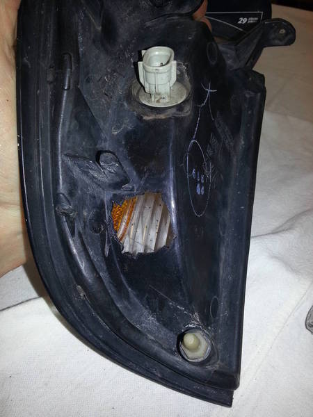

    any one try to do this to blacked out corner marker lights? I am going to be purchasing new headlights marker lights and bumper lights not sure if I want to chance ruining the inside when drilling the hole. hmm. thoughts? also how easily you think I can get my old light housing off my old marker light after I used that vulkem. LOL

    pretty low id think..though im not making any promises. I bet using the heated up pipe method would make it easy.

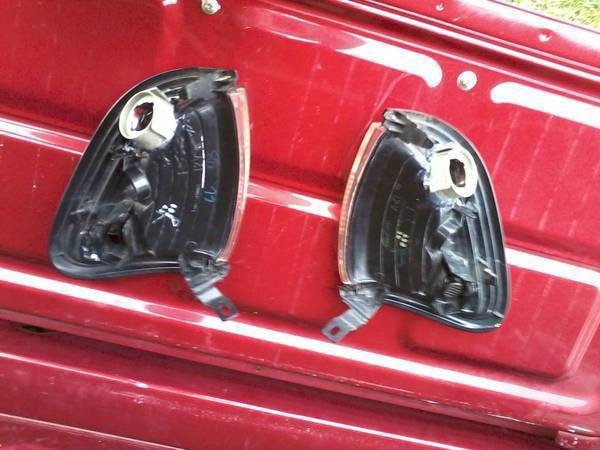

    I was in such a hurry that day when I took the pictures, I didn't realise all you need is a flat head to take the light/contraption holding the light to take it out. It made it so much easier to do it today with taking it off. I did it to my black ones, no problems besides my drill went a little to far and scuffed the inside of it. no big tho.

    Better it just scuffing it then breaking the the lens :p lol thats what happened on my stock corner lights when i first did this haha
    glad they worked on your black lights tho man!

    it cracked a little, nothing noticeable. but no big who needs blinkers any how... dont serve much of a purpose on the trials.
