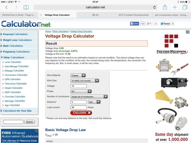

    Hmm I read that a compressor should have 8 gauge if you're going more than a couple feet from your power source
  2. Dec 2, 2014 at 11:45 PM
    #1102
    PSU Taco85
    PSU Taco85 Señor Member
    Jun 21, 2014
    #132394
    2,011
    optional
    '10 TRD OR mostly stock
    Plasti dipped hootus
    10 AWG should be good, 8 would provide you a little margin. Just check the NEC charts and your cable length run to see what the voltage drop would be. Typically anything less than 5% (0.6 volts) is acceptable. It'll depend on the length of wire you are running and the amps you are pulling that determine the gauge of wire to use. Just plug your numbers in here and you should be good to go. Or just listen to swimgood since he's the TW goddess :p
    http://www.calculator.net/voltage-drop-calculator.html
  3. Dec 3, 2014 at 4:24 AM
    #1103
    NC15TRD
    NC15TRD Well-Known Member
    Sep 14, 2010
    #43212
    6,517
    Nick
    PA
    16 Sierra SLT All Terrain
    Readylift, Truxedo, Husky Liners, Carven
    ^^^Take the electrical engineer's advice!
