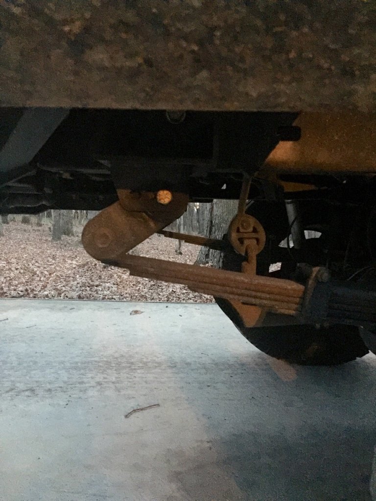

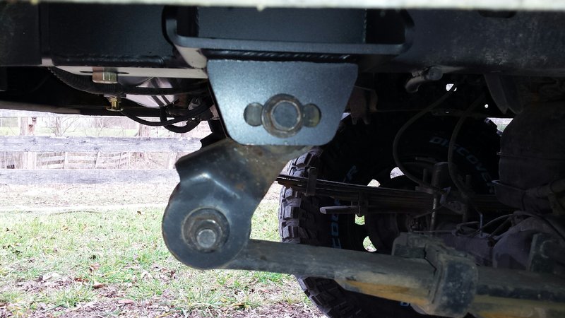

    Heres the shackle angle at ride height.

    I don't know if it's the pic or what but looks like you could go in the furthest forward hole and have a better angle.

    I was kinda thinking the same thing but not sure if it will be too much. I'll try it and see if its better sometime this week.

    I don't know how the stock/add a leaf set up you have would handle going into a negative arch during compression so keep that in mind, my dakars handle going into negative arch fine.

    How was it at full droop? Ride height looks spot on.

    Yea spring rate makes a difference, stock I'd leave that angle but with my dakars I put a little sharper angle on mine.

    full droop was straight down. hard to tell from the pic in main post though.

    Cool, I'd leave it be. Moving one hole forward will increase your effective spring rate.

    Shackle angle is fine, leave it. How long did you fuck with those rivets? :laugh:
