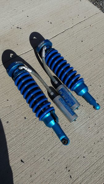

    Have been working on cleaning up the kings. Used WD-40 Rust Soak, expensive stuff but worked great. Dropped the shocks in a pvc tube to soak then wire wheeled them. Shock bodies got clear coated as did the resis; hose fittings and resi brackets got Glam™ silver. Swapped the 600's out to 700's this afternoon. (600's are for sale if anyone is interested)
