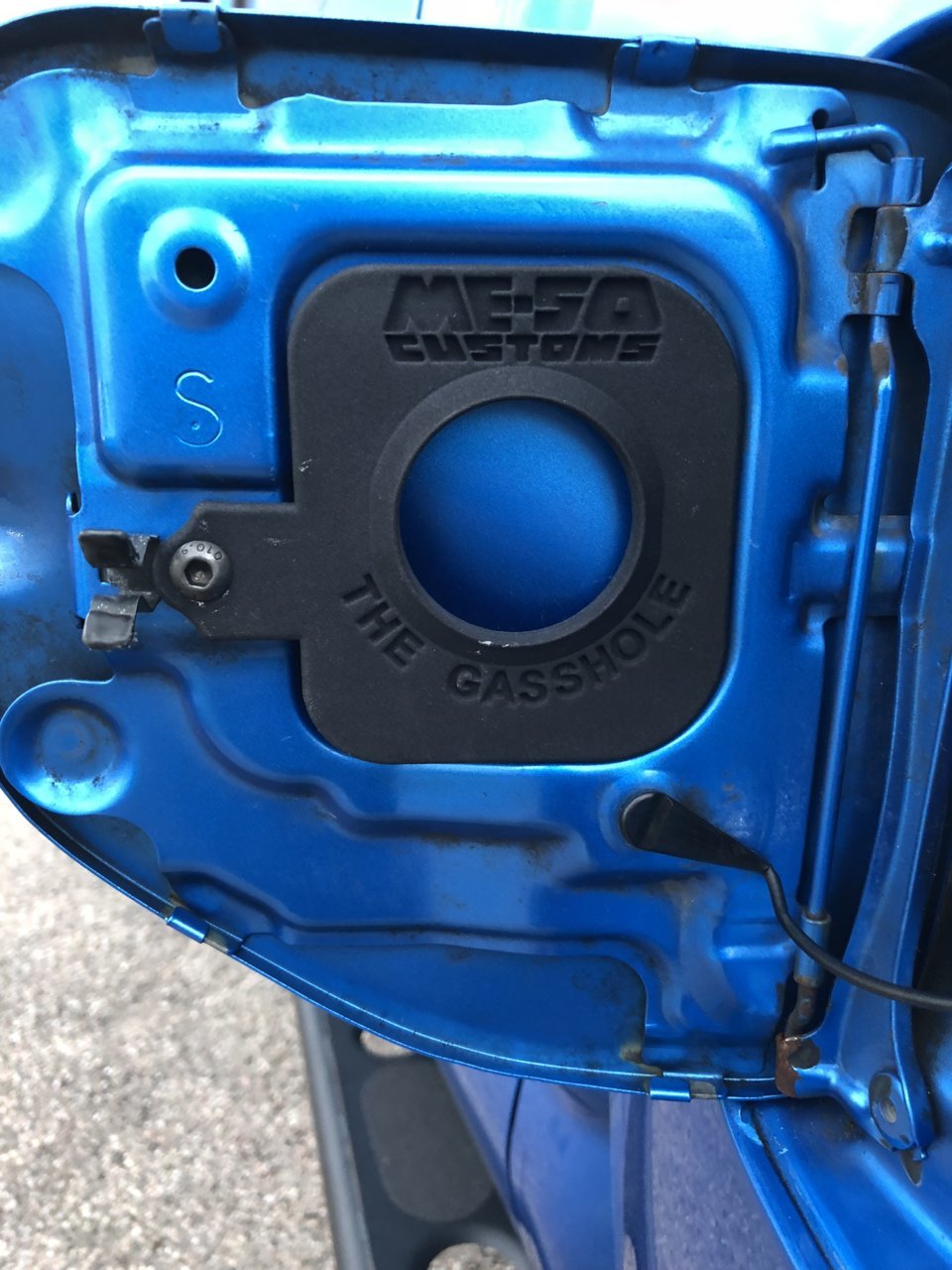

    Everyone has one, that wants one. Happy camper here, yes I washed the black crap out for this pic, most of it anyway. FYI - I got this cap for my 2000 Z71 truck, soon after trading it in. Same cap as for the taco from autozone. Had to use my 3/8 impact to remove the screw, but used regular screwdriver installing this, easy as can be.

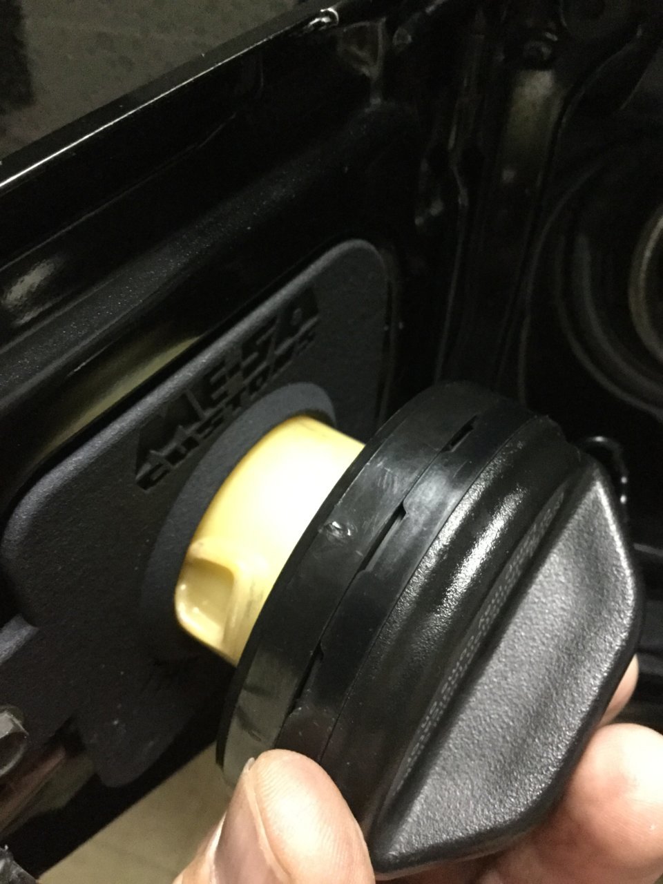

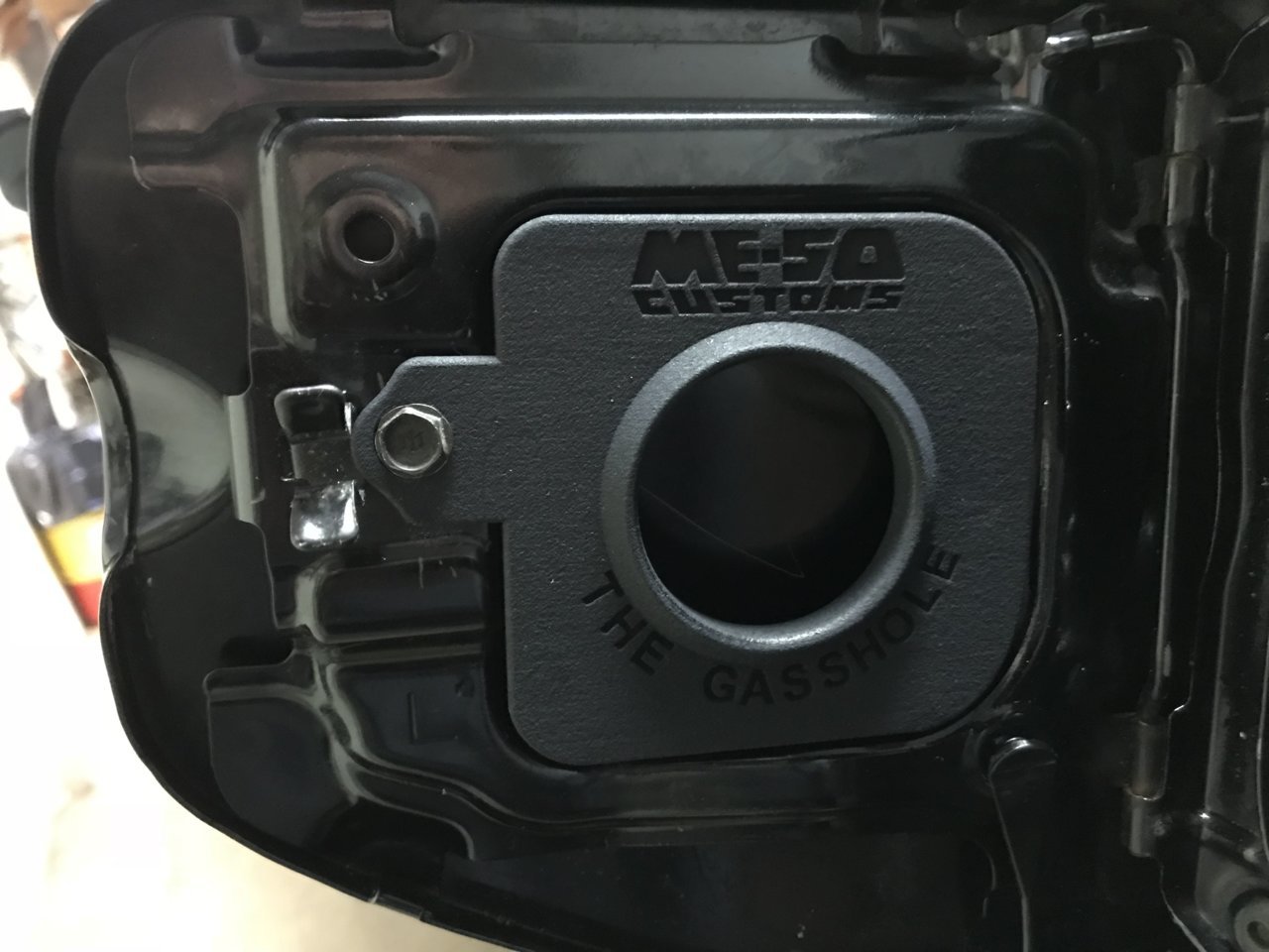

    E96C0EEC-0F4F-48ED-93FF-991A2441DB21.jpg D6183575-81A4-47F9-8F95-E9AB825C8159.jpg Am I doing something wrong, my gas cap does not fit snug enough to stay in the gasshole. I have the original OEM gas cap. Seems like the flange on the cap does not allow the cap to go in far enough to hold.0F4621CE-2CA4-482D-8759-4971976957CD.jpg

    Looks like two types of cap designs based on year. My 2011 has threads not a tab like in your pictures.
    Thanks Toyota. :facepalm:
    Time for a revision change to accomodate both designs.

    Same cap and problem I’m having
    Yeah I saw that and tried the threaded style on my truck but unfortunately it doesn’t close properly because the filler neck is different
    The threaded style cap fits great in the Gasshole, though.

    Yep. I have a 33070 which my truck calls for (notched cap) and it doesn’t fit, but the 06040 which I looked up w/o vin and is threaded fits the Gasshole and not the truck lol

    I was wondering if I bought a threaded gas cap if it would fit the filler neck. You guys answered that question for me. That would have been too simple. You would think Toyota would have some kind of standardization on the caps. 1 size fits all, but again that would be too simple. That screw was a bitch to get out. I ended up drilling it out and used a self tapping screw in its place. Oh well, back to the drawing board.
