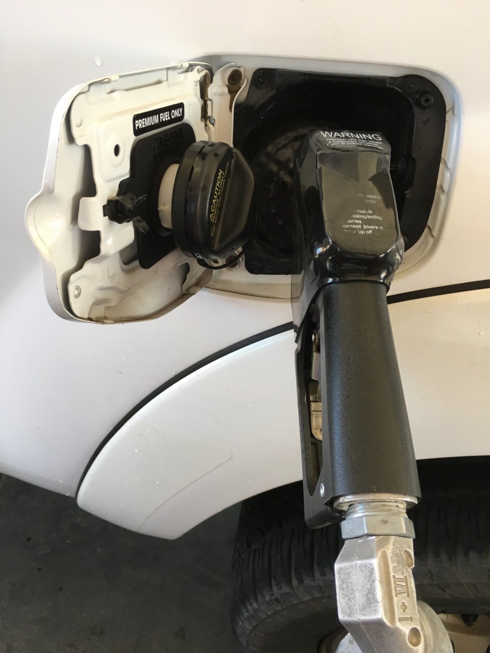

    Got mine last week, screw was easy to get out. I have an aftermarket locking gas cap, doesn't thread into the gashole, but still better than nothing!!!

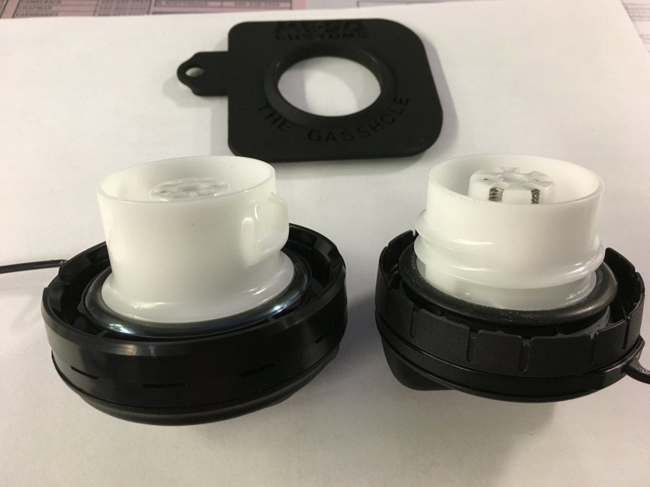

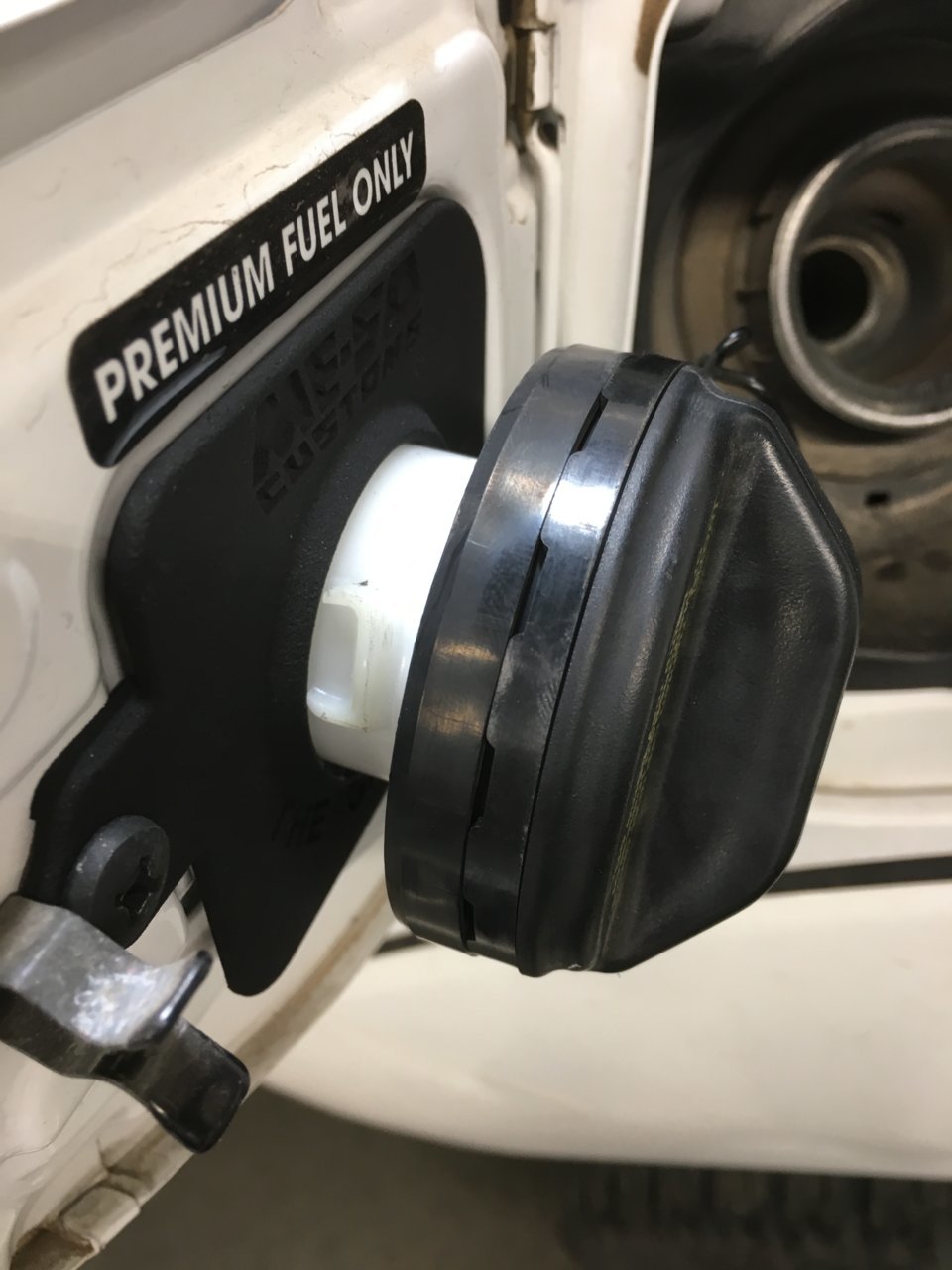

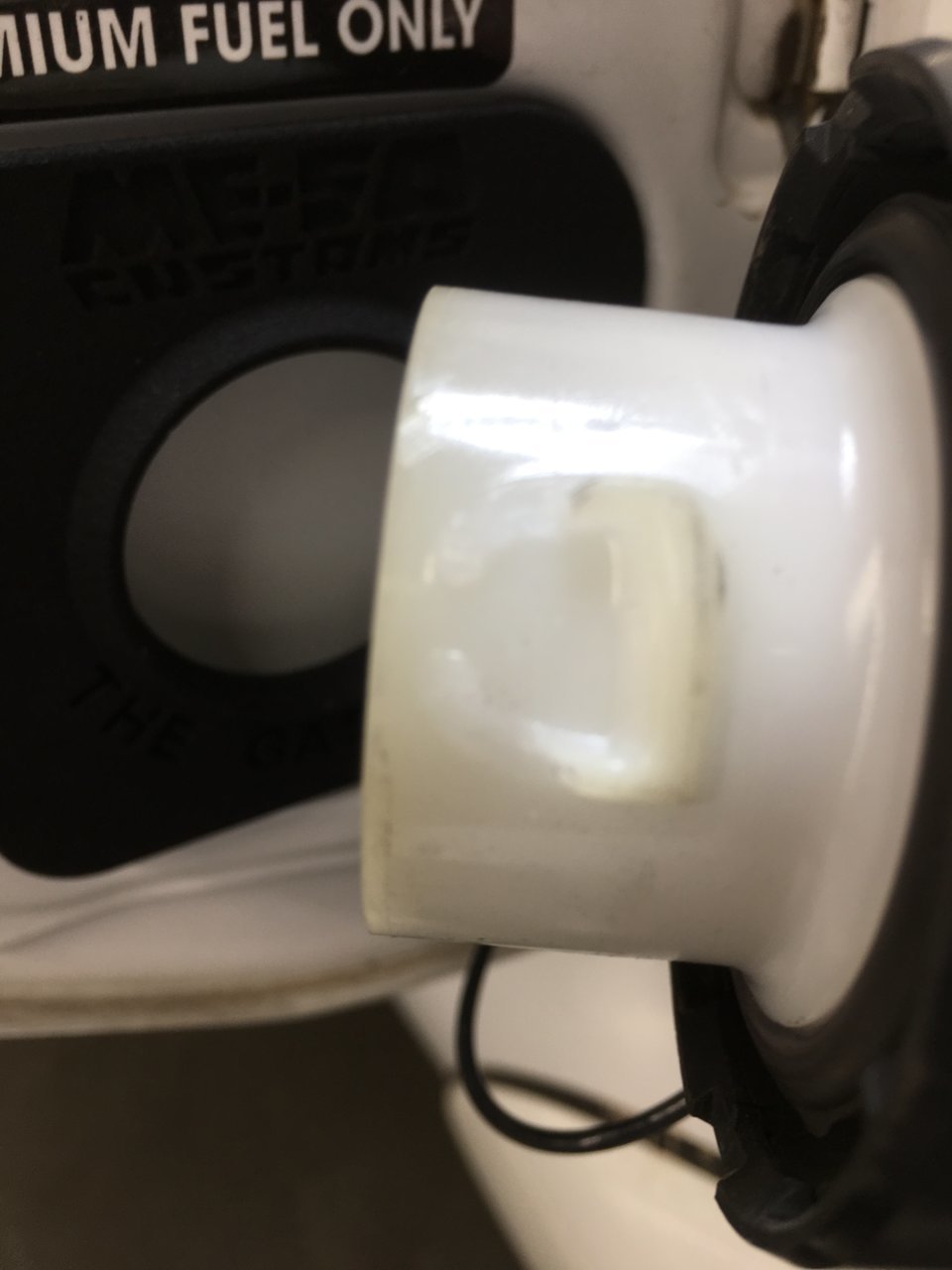

    Houston. We have a problem.
    So, I dunno if this had been covered. But, The Gasshole seems to be designed for Tacos made after May of 2008. Those trucks have a spin on type gas cap shown on the right. The earlier trucks use the 1/4 turn type shown on the left. This style cap does not work with the Gasshole as designed. The tabs that engage the filler neck block it from penetrating the Gasshole deep enough. :rofl:
    I am going to try to modify my gas cap a bit by trimming up the tabs a bit. Ultimately though, I think this product design ought to be modified to work with both styles of gas caps.

    Just notch it out with a dremel. It sucks having to mod a mod but eh its no big deal imo.

    Fixed

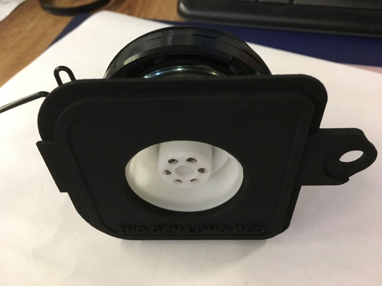

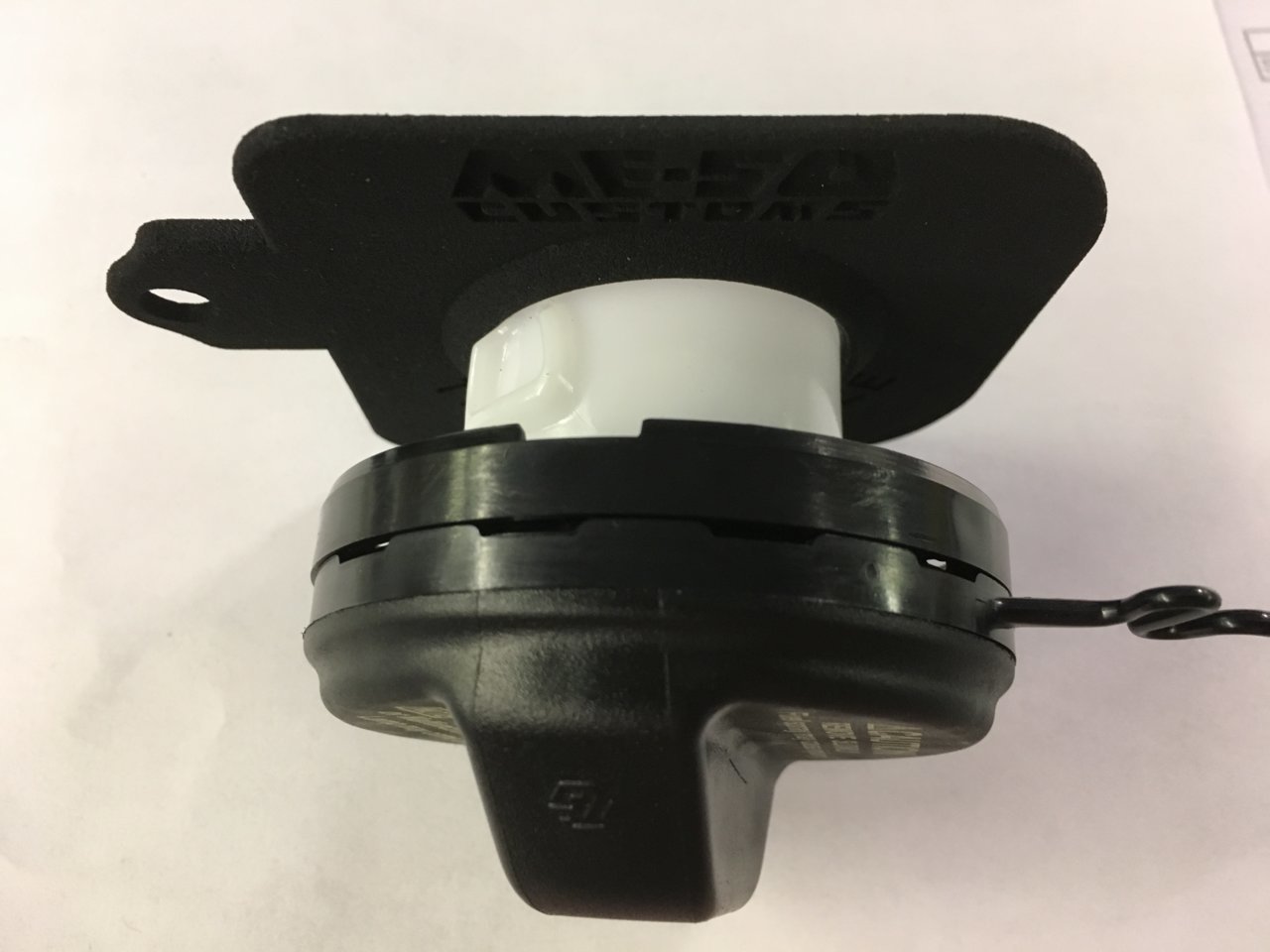

    Sorry, been really busy with other stuff and haven't had a chance to address this or update the OP. It seems that Tacomas PRE-2008 have a retard cap. I haven't been sitting idle, in fact I already have a new design and was waiting for the tester to post up. @05Taco4x4 has the new one and confirmed fitment(post #345). I made it so there are slots on each side to accommodate the tabs in the cap.
    If you have one that is the old style cap, PM me and I'll get you a free replacement for the slot style.
