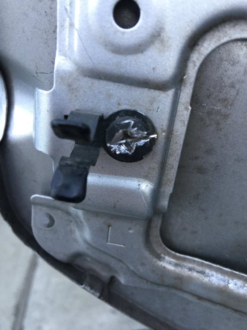

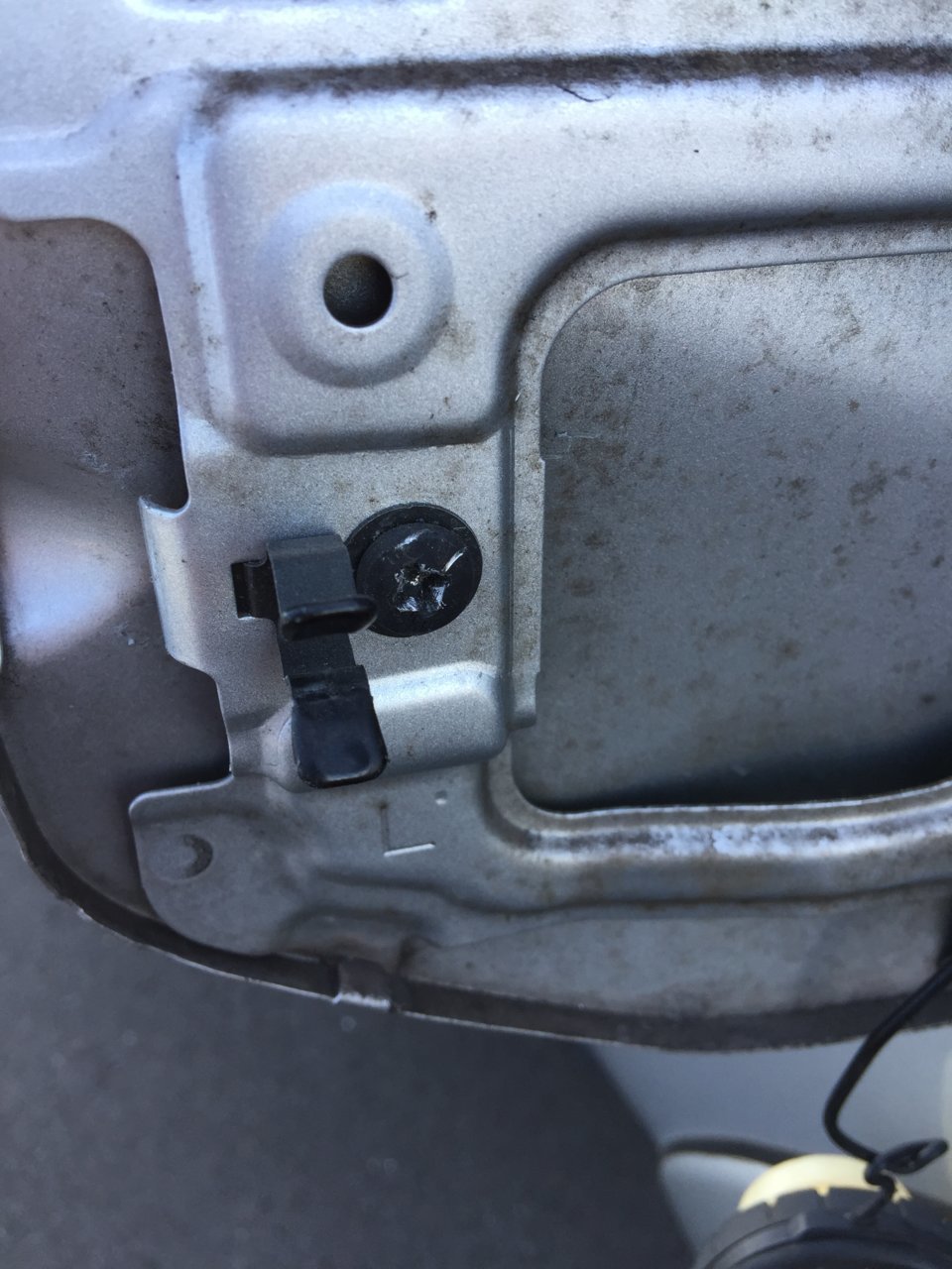

    Got my gasshole today, but it looks like I stripped the screw trying to get it out like a total idiot. Anyone have any advice on how to salvage this?D119E21C-A091-4DB5-AE2A-88AC44B42068.jpg

    What size Philips were you using? Maybe try a #3 Philips, or a Flathead that fits in one of the slots?

    I was using a smaller head when I stripped it, but most recently when I tried to salvage it I was using a #3. It almost turned it, but I think it’s too far gone.

    Yea I would try a Flathead that seats fully across one of the slots and maybe get it with that.

    See if you can grab it with vicegrips. If not, another option is to cut a slot in it with a dremel or cut off wheel. Make sure to protect the paint from sparks. Then use a straight screwdriver.

    ******WARNING*****
    There have been cases where it seems Toyota used super human straight/and or jb weld on the gas door screw.
    My suggestion: spray it with some on blaster/solvent, then use a #3 Phillips on an impact gun. Stabilizing the door from the back with you other hand, use a fair amount of pressure and cross your fingers.

    Vice grips... no luck. Just dremeled it out and tried again. Still no luck. What the hell did Toyota use to get these screws in?
