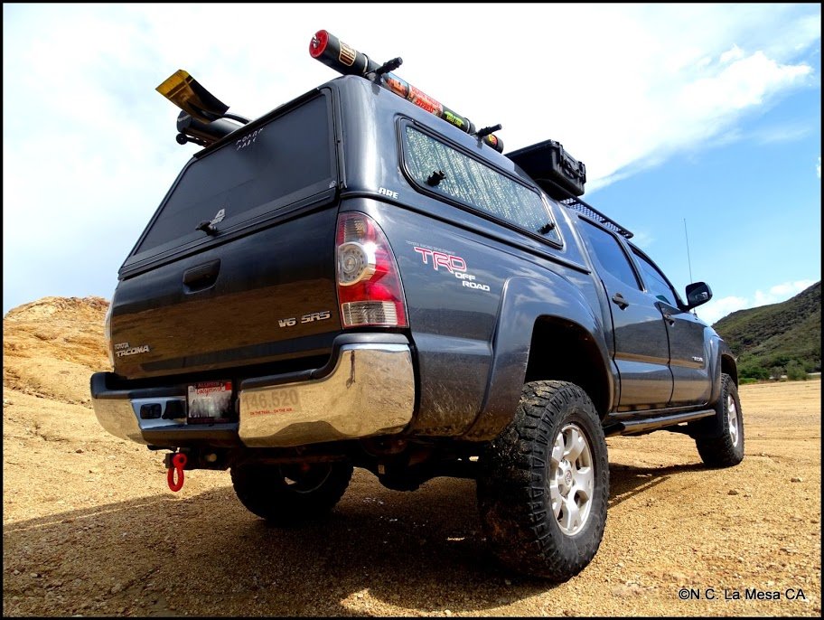

    Normally i don't, but occasionally I feel I need to clean it so I can see if something is wrong.
    The mud river I drove through on Thursday was intense. I can't believe how much mud came out from frame, skids, rear bumper.
    My neighbors thought I went hillbilly washing it on the front lawn. But when they saw how much water it was taking to clean, and the mud coming out, I think they understood. lol :)

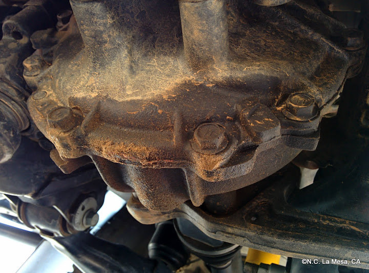

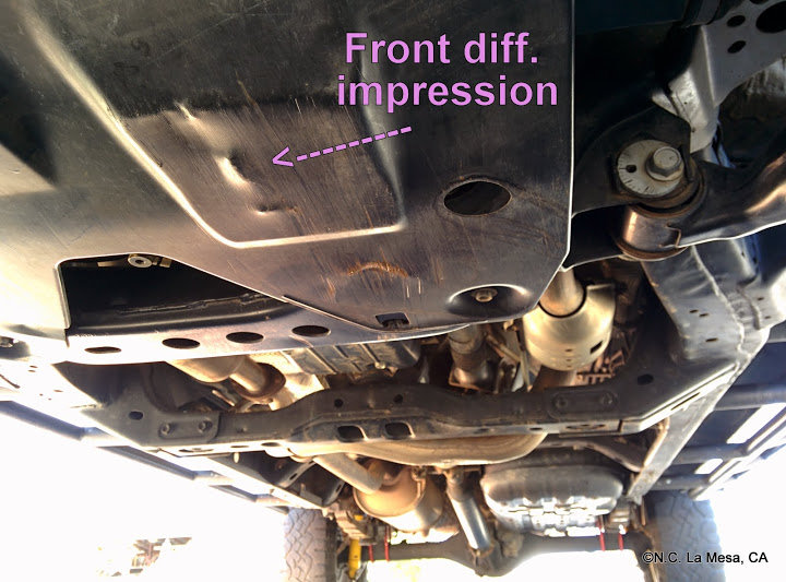

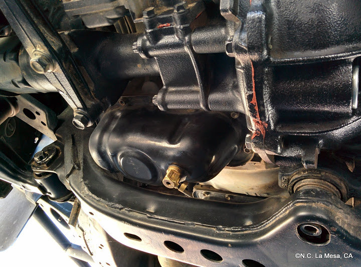

    Well I turned a few more wrenches today and changed the front and rear diffs, and xfer case.
    Unfortunately It seems my front diff may be leaking. Either from the drain bolt, or gasket--can't tell yet. My factory mid-spash guard was molded (dented into) around the front diff clamshell housing. :( I did the drain, replace, clean procedure and will keep an eye on it. Everything else was normal.
    Leaking, wet front diff.
    Cleaned everything.

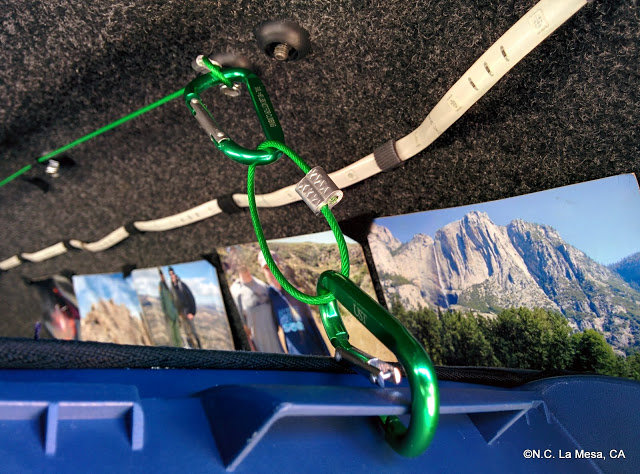

    Today I made a ceiling attachment system for the shell. I used wire rope, ferrule, home made captured brackets. I added loops at ends.
    This is a nice mod, as it allows me to hang lightweight items from the roof, like fishing poles, clothes, wet stuff, etc.
    I'm pleased with it. My almost 5 year old daughter immediately started hanging things. Good to have a helper. :)
    Also, i could not find what i wanted in a home store so, i hand made these brackets. Made in 'Merica!

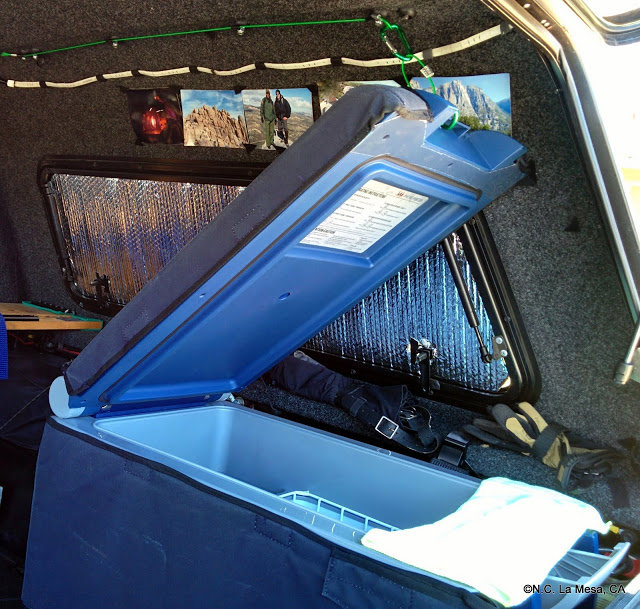

    More fine tuning happening today. Today's mod pivots on yesterdays success. It's the fridge lid holder. :dancingbacon: I kept the green theme alive too. :broccoli: Having been bonked on the head with the lid, wife strongly approves this mod.:jellydance:

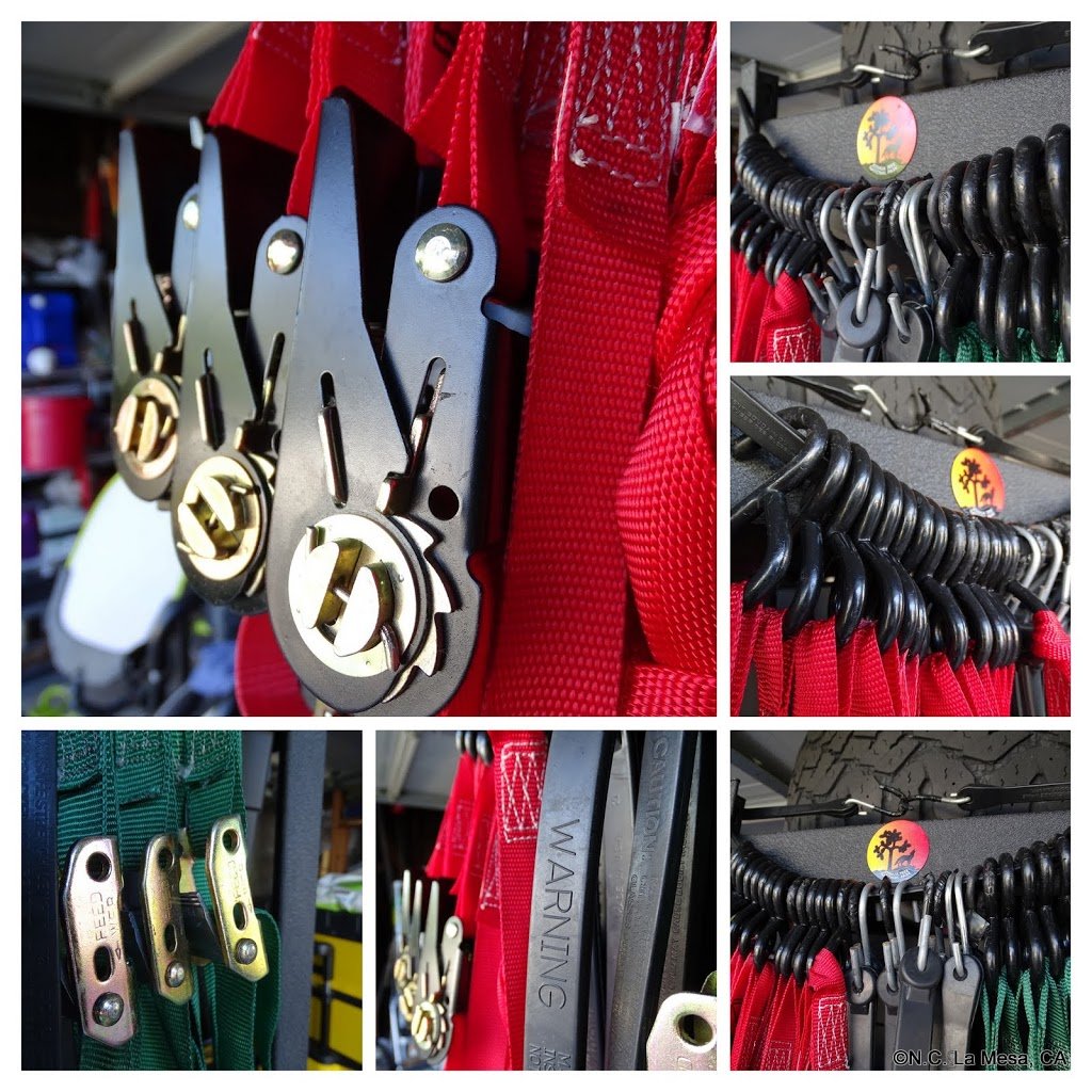

    I was goofing around with the camera yesterday and took some pictures and used my phone to make a collage.
    This is a tribute to that which holds my stuff in place during adventure transit. lol :D
    Ratchet straps, cam buckle straps, tarp straps.

    Thems a lot of straps right there!

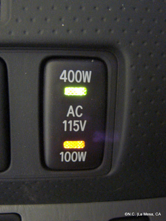

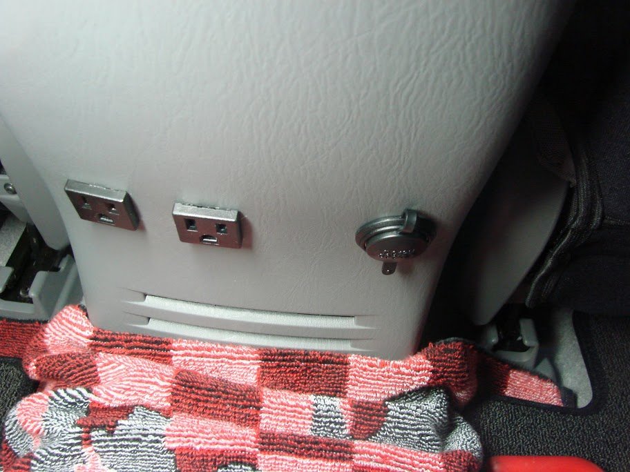

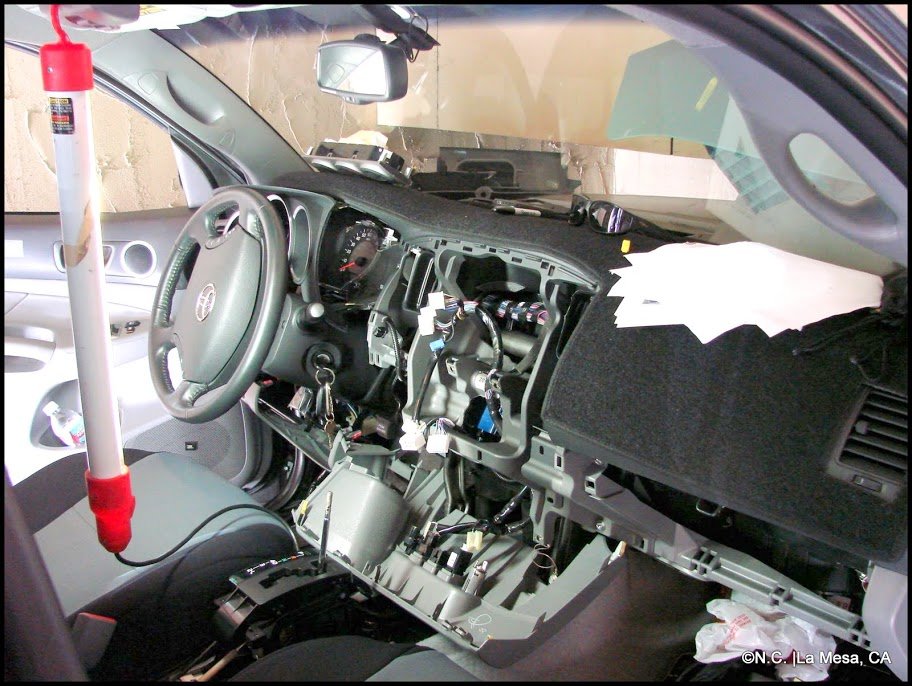

    When my truck was only (3) months old in Oct. 2009, I decided it would be a good idea to rip apart the dash and see how Toyota put it all together. :D This was jaw dropping for my wife, but to me it was just plain fun.
    The result of the work was three mods.
    1. 400Watt Inverter all the time.
    2. Extended AC outlets in back seat.
    3. Extended DC socket in back seat.
    All those mods are listed in the cheap / free mod thread.
    Put the dash back together and everything has been great for (6) years now. :D
