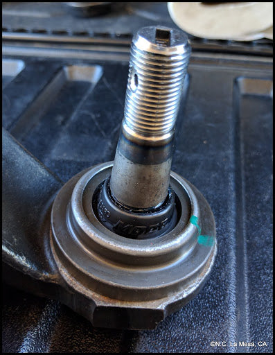

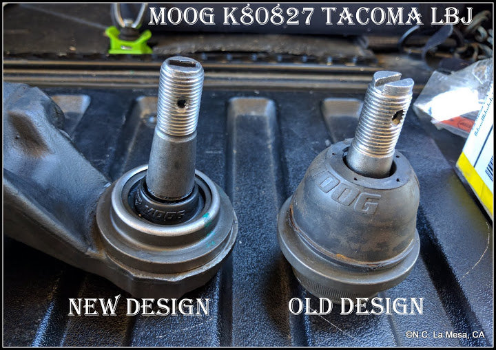

    Brand new redesigned Moog K80827 Lower Ball Joints pressed in!
    Amazon delivered Moog LBJ around 1pm, and I immediately drove straight over to E&M auto in El Cajon, CA.
    Shops like this are classic, and I love them. They can do almost anything for reasonable cost, if you bring it to them.
    They pressed perfectly, two LJB in 20 minutes, for $22.50. :yes:

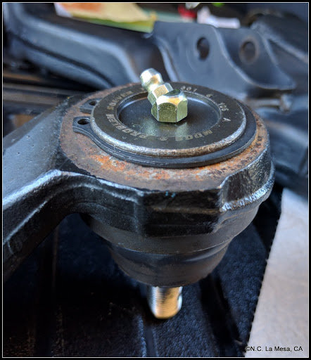

    Also, I found out from Moog today that they did in fact redesign the LBJ.
    • It no longer has a big umbrella style dust boot. (What you see in the photo below is complete!) Here is the marketing speak behind it. "A patent-pending dust boot with encapsulated Belleville washer design is combined with a powdered-metal gusher bearing to maintain long life and controlled axial and radial movement."
    • They also threaded the hole for the zerk fitting. :yay:
    • The top of the ball joint (head), is also different, more shallow than before, which may help with zerk fitting and not hitting CV.
    After studying the new joint for a while, I decided it would be even better if I moved the dust boot from the older design LBJ (still new), to the new designed one.
    Now the LBJ has two layers of defense! lol :D

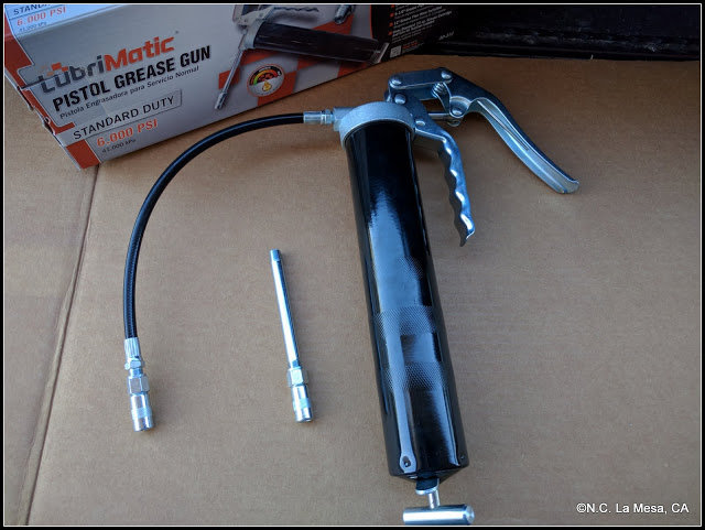

    Today I also picked up a new grease gun for a brand new 14oz tube of Prothane Super Grease that's on its way.
    It's expensive grease! $41.53 for the tube. I know of no other market alternatives that have the same incredible waterproof ultra-tacky adhesion qualities, and also PTFE based.
    It's necessary for the poly bushings. It should last a very long time, so I'm okay with it. :)

    I like that gun. So much better than the lever style. Need to get my hand on one of those. :D

    Where did you find the Prothane grease? I should probably get some for my UCAs.
    And the grease gun - I looked on Amazon and they didn't list it.

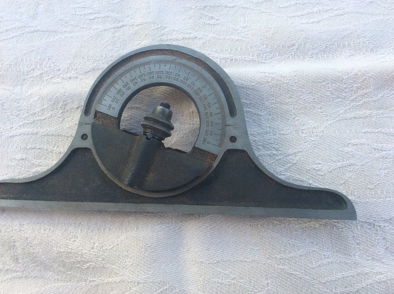

    Hey Nick, does your angle finder look like this? Lol. This has a spirt level on the other side and can be very accurate, but not digital.
    Crom[QUOTED][OP] and ChadsPride like this.

    Starett for the win.

    And thanks for the tips on the grease gun.
    This will be my first pistol style gun. My other one is a lever one, and it works, but it can be cumbersome at times. For the Tacoma, I can't see any issues with the pistol grip one. Some guys say they don't fit into tight places.
    Lubrimatic - For more than 40 years, LubriMatic has been developing and distributing superior lubrication products. Part of the Plews & Edelmann family of products, LubriMatic serves the industrial, hardware, marine, automotive and agricultural markets, as well as many industries requiring professional grade lubricants and penetrants.
    Haha! It's what the Terminator used in 1984 to find Sarah Connor when she was 19 years old working as a waitress at Big Jeff's Family restaurant. :rofl:
    Bought from Amazon, on Amazon, https://www.amazon.com/dp/B004JMEC0E/
    Best price I could find.
    The gun I found at Wally world in the automotive section, and was mostly an impulse buy. I figured I'd try it and if it holds up I'll keep it.
    Honestly, I took it completely apart and all the threads are cut clean on the fittings and has some heavy duty rubber seals, which I greased with PTFE. I can't find anything I don't like about it. The hose is rated to 5K PSI, which is better than some others.
    That's a really nice tool right there, and it will probably last forever.

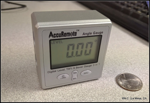

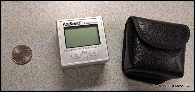

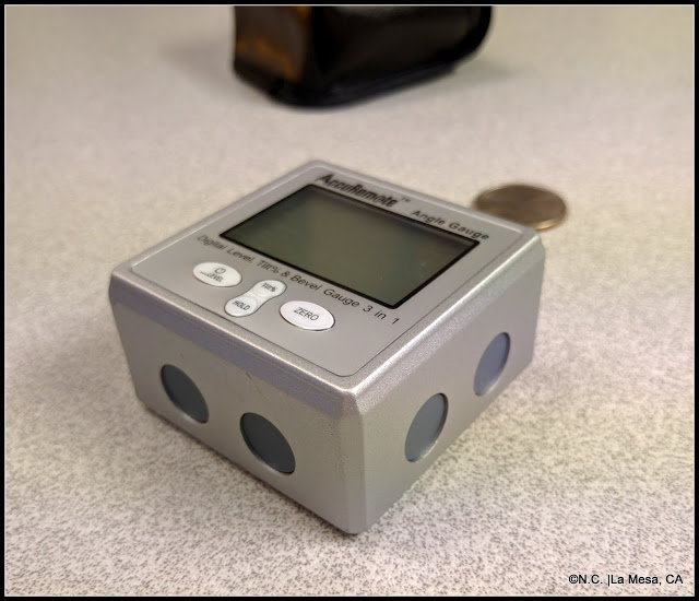

    This is the angle finder I bought to measure my drive line angles. So far, I like it.
    AccuRemote Angle Finder.
    • magnetic on three sides, (Bottom and sides)
    • Display will automatically invert if turned upside down, very nice.
    • All aluminum case, four screws hold the back on, and came with small screwdriver and carry case
    • Weighs 7.4oz with 9v battery. It's dense for its size.
    • Measure range: 360 degrees (4 x 90)
    • Resolution: 0.05 degrees
    • Accuracy: +/- 0.2°
    • Standard 9V battery (250hrs) included
    • Displays relative/absolute angles in degrees or tilt percent. Measure range: 360 degrees (4 x 90)
    • Dimensions: 2-3/8" x 2-3/8" x 1-3/8".
    • Assembled in China, Designed in California.

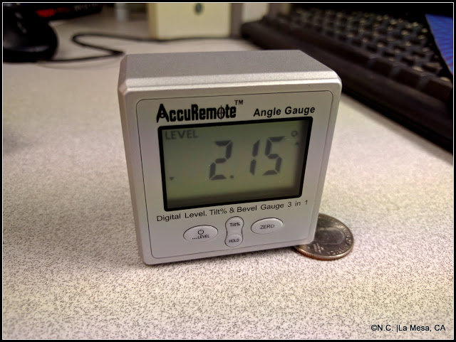

    My work desk is level. :)
    Slipped a quarter under one side, and angle of measurement is 2.15°
    So far it looks like it's going to work beautifully.
