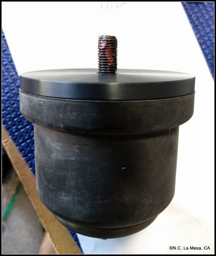

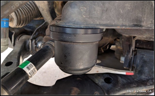

    Front Bump stop shims added, 1/4"; made from machined UHMW.
    UHMW is very tough, and has the highest impact strength of any thermoplastic that is commercially made. It's a great material choice for a bump stop spacer. Got mine from
    Note the red grease on the bump threads. The bump stop bolt threads to into a threaded hole on the frame where they are exposed on the backside to the elements. Some people snap the bolt because of corrosion. Greasing the threads helps guard against corrosion. I greased mine over a year ago when i first installed the bump stops and had zero issues getting them back out for install of the spacer.

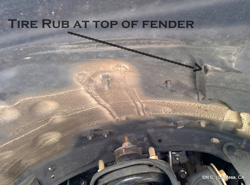

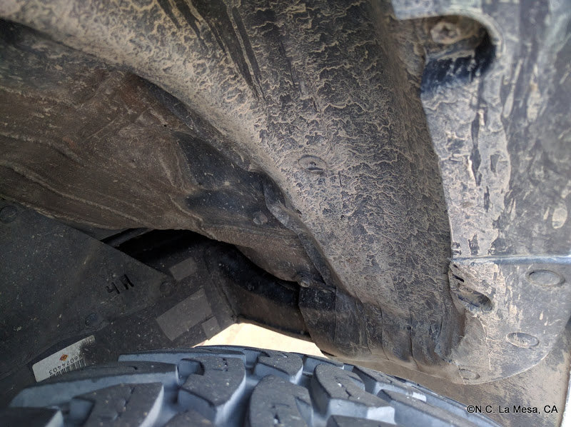

    The Toyo's only rubbed under very hard compression, usually from spirited driving across varied terrain.:mudding:
    WvIEh8EcvPcq9brfGiSJ0WzCoYURynnTQNLLS_Wz_94403a988c025f2e2ef31584b2bd31326f907e39.jpg
    HsP_FjAER3YDayA9mmk0PGeUBV1PJrkgslQ1x0IZ_73e1677ea4ed1f998dee3b4dcbcd9f9527376e43.jpg
    The spacers have completely solved my rubbing issue based on last weeks wheeling trip. :kona:

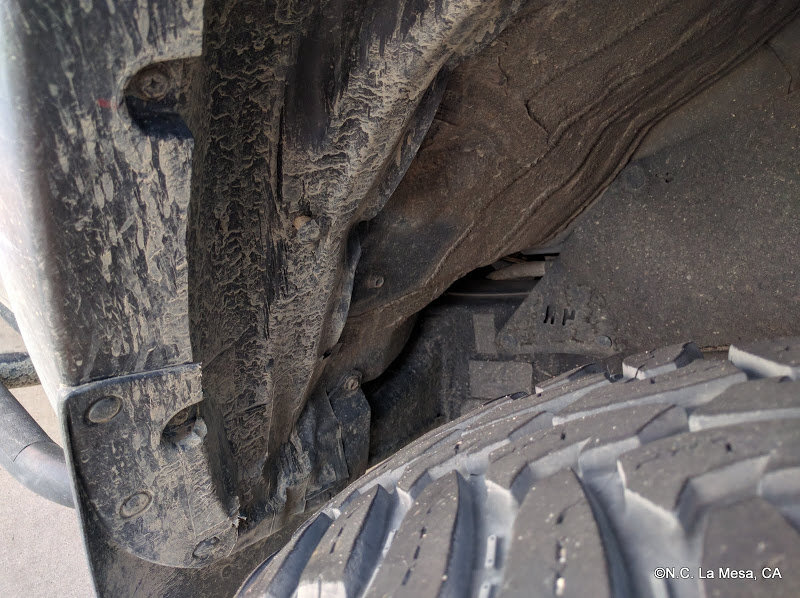

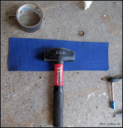

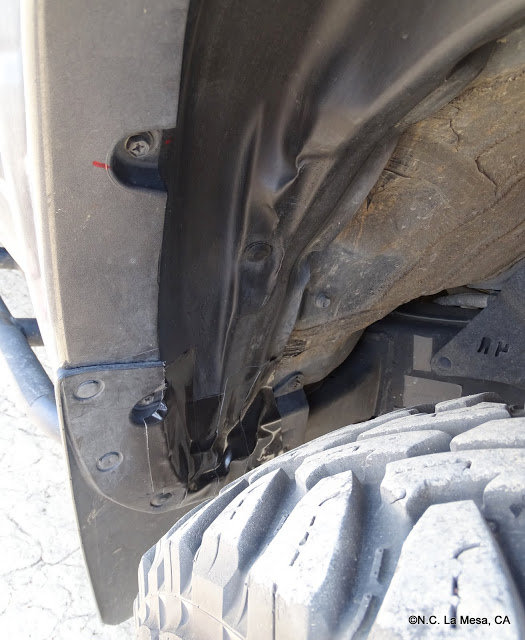

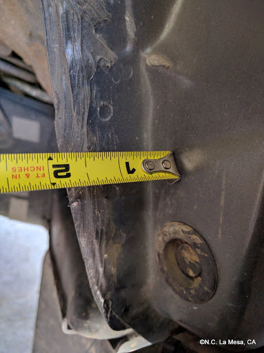

    Beating the pinch weld flat with a sledge hammer.
    I put this task off for the longest time...
    It turns out this is a very easy task and it's necessary to clear 33" tires at full stuff, lock-to-lock steering. It takes longer to remove the stuff in the way than it does to flatten the pinch weld out.
    Before undertaking this task, I solicited input in this thread here: Beating your pinch weld flat with a sledge hammer. --Let's discuss!
    The thread was helpful to my understanding and my take away from that there was there is no wrong way to do it, as long as care as taken. I will say that I went with @Evenflow 's advice. I beat the pinch weld flat to the outside to gain the most clearance. Thanks Jason!
    Also special thanks to @GHOST SHIP @nfs257 for other advice, and @MonkeyProof for his pics and description in this thread.

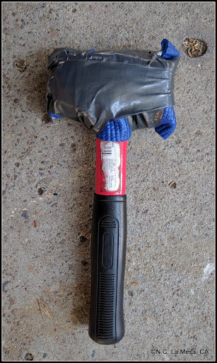

    I pad wrapped my 2.5 lb. sledge and had zero damage to the truck paint. No need to paint or seal. It worked superbly, and I gained a lot of clearance. After the beat down, I used a heat gun to reform the plastic fender liner.

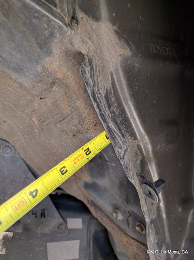

    The pinch weld itself is 14" long, nearly 2" tall at the bottom and 1" tall at the top. It's much more robust at the bottom. Still a very easy task, just go slow.
    These are pics with the fender liner moved out of the way, I pulled the clips and pushed it to the front of the truck.
    T-zSnom8wUPXH9Ehc7TWy09LbFM8ZnYD5W0DNYAU_22291a00c184d9a09eaebb03eaecd0234c062e28.jpg
    Top of pinch weld.
    PoBRdBNK_KmNH10k2aY7mPSA4-XeDHRdoP0213MO_20310daafaed179dfbb97fc105d3e7e064f994be.jpg
    Bottom
    cgwMzyrLWAlBi10OkcMcSongL0v7HmHKX4narYFH_c037e5b605c6e2488290a0d32fa689951807bcb6.jpg
    My tool of choice, 2.5 lb. sledge, blue 3/16" PVC, and duck tape

    All wrapped up and ready for beat down.
    JCQNXu37c36S68ukZYm5aWININK_qYWCoOPUytm3_3dca52361e2f2c68e6b7d86cac53d7851f257bb5.jpg

    I'm quite pleased with the outcome after field testing! There is only a very little left to trim from the mud flaps, but the bulk of it is done. :cheers:
