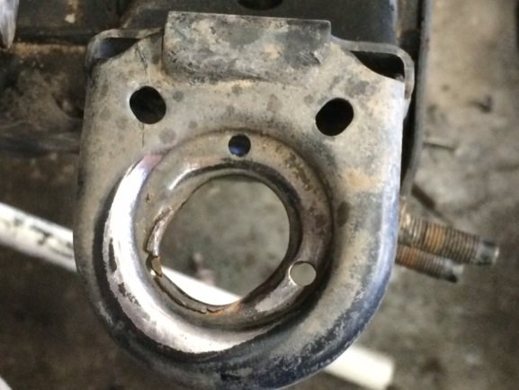

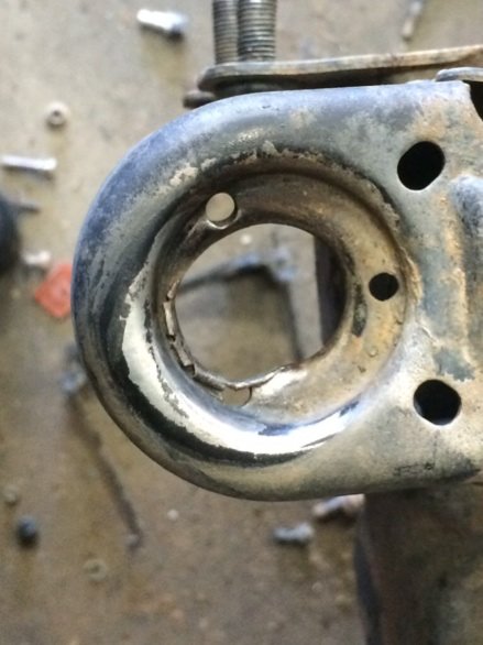

    My opinion is that the factory core support bushings that Toyota supplies on our trucks are inadequate and should be replaced by anyone who offroads period, even pavement pouders should do it.
    Energy Suspension makes a great universal bushing kit that works great for our trucks and is super affordable. 9.4101G. When I replaced mine I was blown away by how much more solid the front end felt when pulling into driveways and what not. Very impressed and highly recommended.
    I just went outside and checked the truck and it appears I have about 1 CM more clearance. Extremely close to stock height. It could also be that my truck's cab is not perfectly aligned with where it once was too. It could be off a tad.
    On my truck, the pinch weld very close to the front cab mount makes a downward dip and becomes very close to the sliders I have welded on my frame. When the truck was in very off camber situations, the pinch weld would score the slider. It never bothered me or the truck, just an observation. I'm quite curious if the ES bushings (once torqued proper) will allow the same kind of cab flex.
    Also noteworthy, is you can flip the bushings upside down for a body lift if someone needed that. I think 1/2" can be gained that way, but might have unpredictable side effects.
    I'm really glad you brought this up.
    The "C" plilar cracks. I don't know what it is about it. I first heard about those from @HBMurphy.
    When I was pulling out the cab mounts I noted that the rear mounts and front mounts are not the same, when I saw this, I looked up the factory part diagram and sure nough, different part numbers.
    When comparing the images below, notice that the rear mount on the left, has a smaller neck with less rubber. The steel bolt sleeve is also a few mm longer than the front, had to use a caliper to discover that.
    The rear mount has had a lot of stresses applied to the rubber on the underside and both showed cracking with a 180* radius from the direction it was flexing.
    The front mounts were perfect condition on the underside. Zero cracking there, and only had minor cracking all the way around the neck. IMO, they were in very good shape for nearly 70K of travel on / off road.
    I wonder why Toyota used different mounts for front and back of the cab?
    And could the cracks in the C pillar be prevented if different mounts were used in the beginning?
    Thanks!
