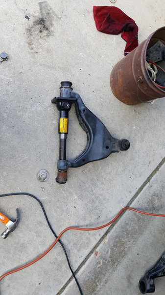

    Hey Crom! I'm going to follow up on the poly bearing when I get home, but do you recall seeing an option for us 1st Gen guys? Thanks in advance!

    I seem to recall a first gen using the poly bearing in the IEDLS thread. Search thread by title using IEDLS to find it. Was on one of the last pages...
    Yes. All four came out that way for me. Roasted them for about 3 full minutes, even heating the seat, pencil torch propane tip. As I recall they start to smoke a little and buldge before they released.
    Sorry yours didn't.

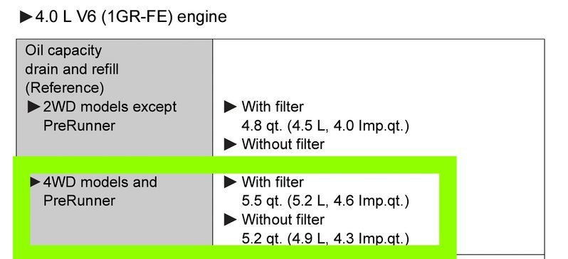

    Good evening Crom. I noticed you put 5.4 quarts of new oil in when doing a oil change. The book calls for 5.5. I know it's not much of a difference but I was curious why.

    I took a square to the bed upgrights, and they are good. I have tailgate seal all around the edge of the bed so if there are any stress cracks they are concealed.

    Thanks, good catch.
    I think I wrote it wrong. 5.5qt. is right for 4x4 V6. :)
    Post corrected.

    I put 5.5 quarts in and it shows a little over full on the dip stick. Not sure if that amount goes in the filter at start up. The OEM filters come with a check valve that should keep oil in the filter. Since my first vehicle I always go by the amount recommend in the owners manual. When shopping for my new on the lot '04 Taco I checked the oil before I test drove it and the stick was dry. They brought out a tech and the end result was the truck had the wrong dip stick in it from the factory. Also I've heard folks putting 6 quarts in our V6's. A lot of dealership do that.

    I bet you're right. The owners manual even specifies different amount for non filter change.

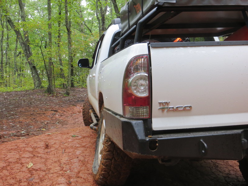

    @Crom , it's probably worth looking into bed side stiffeners even if yours are square. Mine are square too (most of the time), but it looks like I will have issues soon. Here's my 2014 with 36,000 miles:
    Edit: I first noticed varying gaps on the sides of the tailgate when I was flexing to test tire clearances, so I guess that brace is moving a little with the frame flex.
    scocar and Crom[OP] like this.

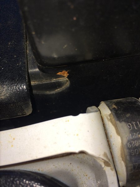

    That's a crack right there?
    Shoot. I wonder if I should pull up the tailgate seal a little on mine take a look...
    Either way, I think you're right.
    The stresses to the bed uprights are amplified with loaded bed racks and shells, I would think.
    Thanks for the pic.
    Are you thinking of use the TC ones? Seems like an easy part to fab if the integrated tie downs aren't needed.

    I use a loaded rack sometimes which I'm sure is the cause. It's not cracked yet, but it will soon. I plan to fab something up myself.
