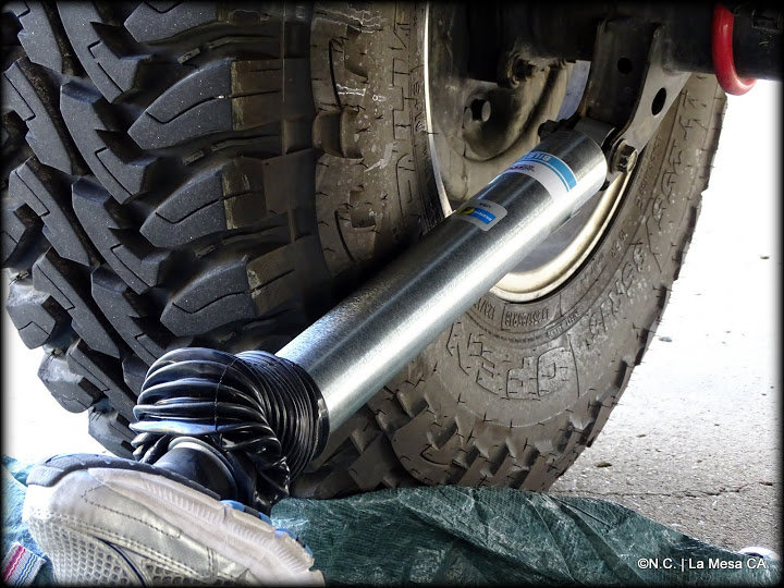

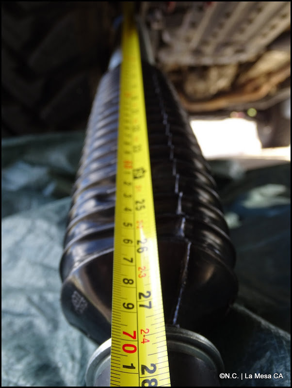

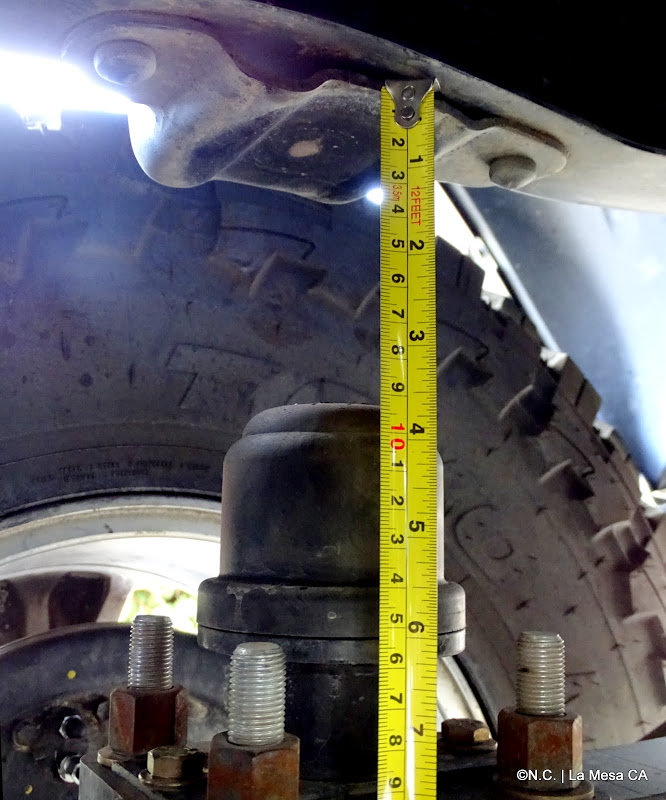

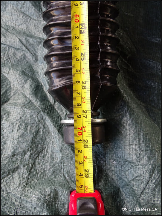

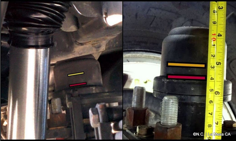

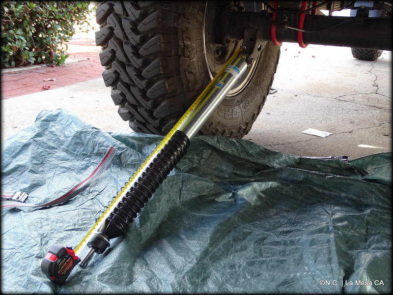

    Jesse, you got me to take a better look at my truck and yeah the bedsides lean out, and it's quite noticeable if you're looking for it.
    I also compared my tailagte gap to another 2009 which is a pavement pounder, and just eyeballing it, the gap is not 100% true from top to bottom, it bows ever so slightly at the top. Seeing that and seeing mine, it's clear mine are bowed out a few mm too much.
    When I measured the metal uprights and they were square for about 12" or so, then slightly taper off. I'm guessing the TC bed stiffener pulls in the top of the upright, hence the reason they are so tall. When I use my hand to push the bedside in to try and make the gap closer, the bedside will flex (as does the shell :eek: ) (orange arrow pictured below)
    I may get the TC ones but I'll have to work around the gusset on the pass side so I don't loose loading space.

    I think I could do all of this measuring and math, but I don't need to. Why? Because Nick already did it for me. I have the exact same shock, the exact same Dakar leaf setup, the exact same DCSB. So I will go with the exact same bump stop height. Based on the pic, it appears that the bump stop is 9" tall. Is that right?
    Crom[QUOTED][OP] and ChadsPride like this.

    If you go with super bumps like I did, you'll probably be safe. In the pic I was measuring the distance from frame to bottom of the polyurethane bump stop.
    The poly is attached to a metal perch that's bolted to the ubolt flip plate. Eye balling it from the photo, the poly measures 2" 3/8 tall. I don't know the total height of the assembled contraption (perch +poly).

    Thanks Nick! This helps a lot.
    I'm an idiot. I was looking at your tape measure for scale and eyeballed the total height (perch + Poly) "9" as inches, when in fact your tape measure is centimeter AND inches. So yes, by my eyeball, the poly is 2-3/8" and the perch appears to be ~ 1-3/8 to 1-1/2"
    Thanks so much. Makes my life easy having you do all this math. :)
