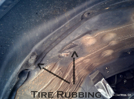

    Spacers were strictly for stopping the tall tires from hitting tops of wheel wells under heavy compression. They seemed to have worked based on last two wheeling trips.
    In the not too distant future I'll be doing some front end work... When that happens I'll pull the coil over out and test for clearance all the way around including confirming bump stop height.
