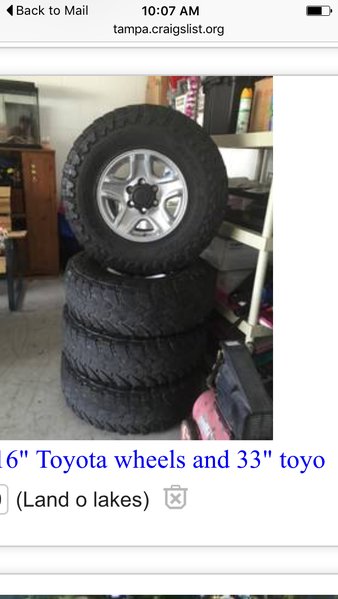

    I personally wouldn't. Maybe take the spare and experiment with it before doing all 4. Here's a picture of that wheel wth 33's and black center caps. image.jpgI

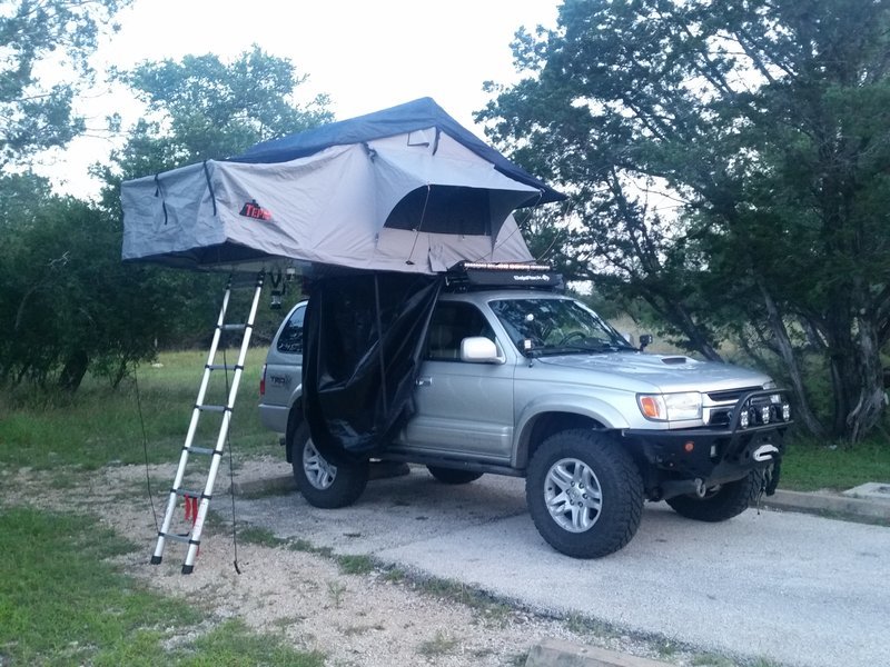

    They are a classic wheel, and the light color shows off the classic design better. The also contrast with your MGM nicely.
    As a former owner of a set, you must listen to me.
    If you can't help yourself (gulp), Plastidip one to see what it looks like. But don't fuck up a nice clean set of these classics.
    I have seen them look pretty sharp painted MGM on a silver truck, and that I would consider. But that ain't your truck.

    my 4runner has the sequoia wheels
