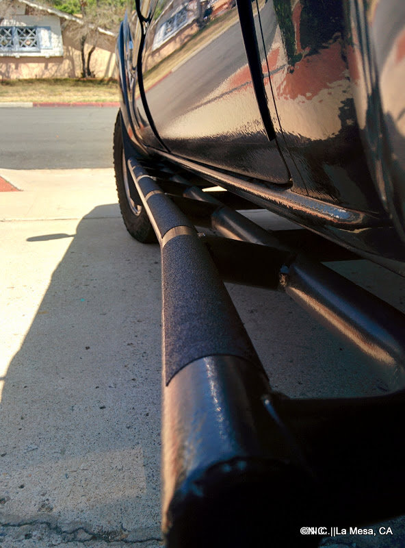

    Got out in the garage today and added commercial grade grip tape to the rock sliders. I did mine is about 12" sections. Thanks to @MrGrimm for the source of the tape! It's 3M Safety-Walk Outdoor Tread, Black, 2-Inch by-180-Inch. You can find it at HD or Amazon.
    Because it's a 3M product the adhesion is incredible!

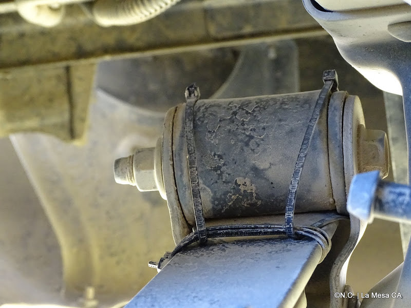

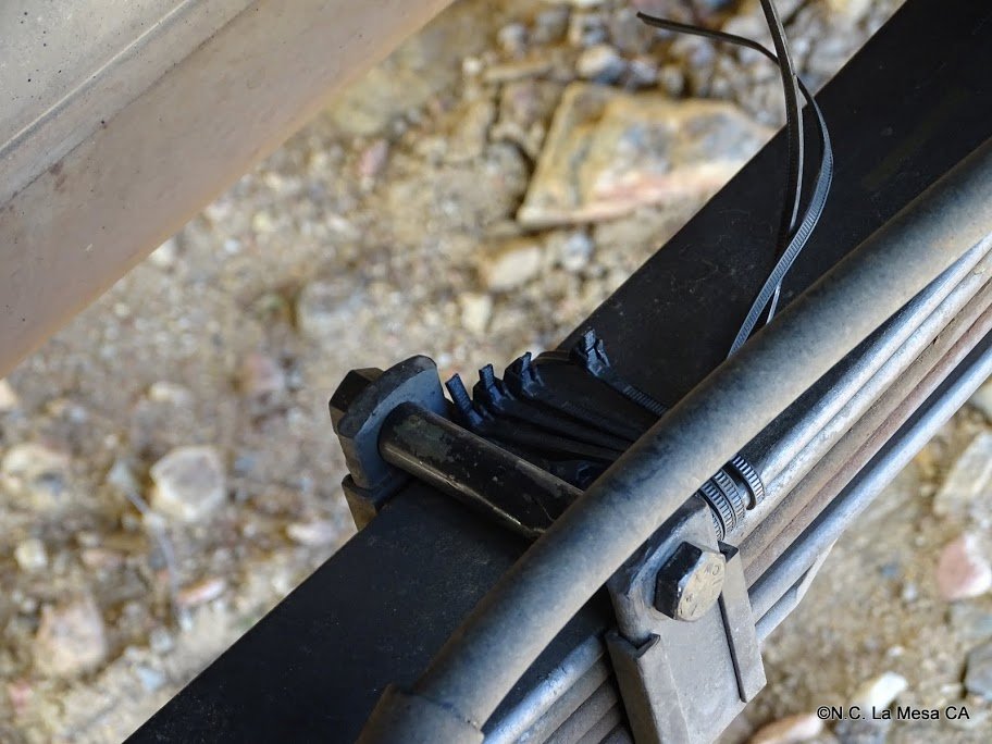

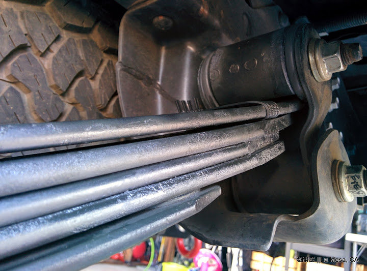

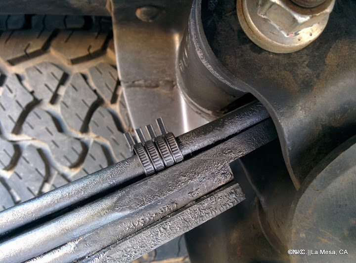

    Solving the Dakar Leaf Spring Squeak
    EDIT: This post was obsoleted by this post:
    Dakar Leaf Spring Maintenance (holes drilled for isolators), Oct 2016
    While in the lab today I successfully diagnosed and solved (for now) the horrendous squeak on the driver side leaf spring. :cheers:
    It was the 2nd leaf from the top down, vibrating against the main spring. I originally thought it was the urethane bushing, but it was not.
    I jacked up the truck, drove the leaf springs apart, blew them out with compresses air, gave them a shot of dry moly lube spray, and installed some zip ties. The noise is gone for now. I am going to service the passenger side tomorrow and proactively do the front end of the springs as well.
    Here is a video to hear how bad the noise was.
    https://youtu.be/mtPfqzxJK2s
    Edit: I had to add something to keep the zip ties from walking down the leafs, when the leaf pack flexes.
    Three of the four are holding after a few month of wheeling trips. One broke and the zip walked down and noise is back. I need to fix that one and I know I need to beef up the zip ties, I used what I had at the time.. :(

    I serviced the passenger side Dakar spring today and leaf springs are silent again! Wooooo!

    I recommend it. I use a hi-lift to lift from slider, and jack thru all the rear suspension for the side I'm working on. Then I place a screwdriver between leaves, and hammer it in to spread the leaves apart.
