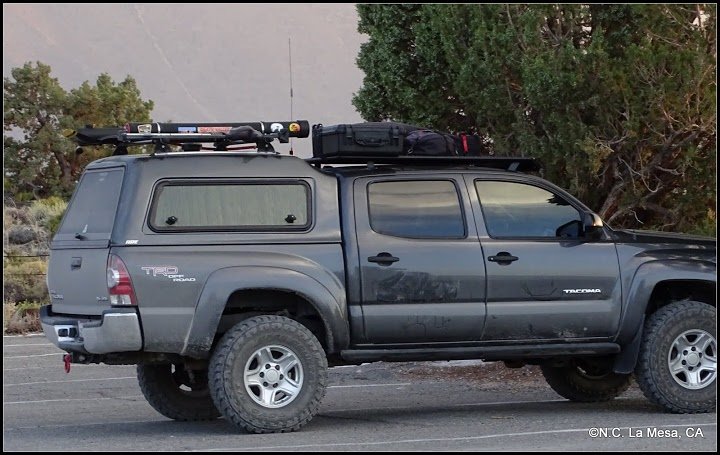

    Longer Yakima bars installed (58")
    I had these at my disposal, so I upgraded to the longer bars. It added 10" of load space, 5" longer on each side than older shorter 48" bars.
    The 48" bars have worked well for me over the last four years. However, there are a few times where I wished they were just a tad longer. Now I have that option and allows me to do a little bit more in the future.

    What is the goal for the longer bars? More to strap stuff to up top or some Crom invention?

    4 years. Yes bedside supports appear to spread a little bit at tailgate. All fixed up now.
    The OCTaco ones sold here on TW.
    Thanks a million for your Sept update post in your build. That gave me the final motivation to get it done. Much appreciated.
    :hattip:
    Nothing too original.
    After a little more work, the longer bars allow me to safely stow a spare wheel up there, in the event I had to, not planning it.
    Also makes tarp deployment better
    And gives me option for integrated storage (inside the Yakima bars), of 1/2" bent up EMT for an extendable shower curtain rod. Not sure when or ever that might happen, however with the longer bars it's a possibility.
    Also in the future, I might pick up some unistrut to cut up and build a super low profile basket.
    And if It that happens, I'll probably just finally buy a TIG welder and some aluminum and really have some fun. :D
