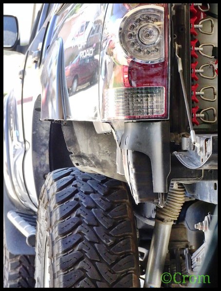

    Nick, before cutting the inner fender liner, let me take a picture of how I left it long behind the hc bumper. It really helps keep the tire spray off/ out of the rear cubbies. It involves modifying and reinstalling the lower rear bedside braces.
    Edit: Here is a picture I took before covering it up with a mud flap. Sorry, the new mud flap bracket is in the way a little. I just trimmed and bent the bracket to hold the liner behind the bumper then trimmed it all to length.

    Awesome! Thanks and thanks for the photo!
    Great minds think alike. :)
    I left both liners uncut for the same reason. I want to retain them.
    I'm using a small string to pull them back for now and I kept all stock brackets and bolts.
