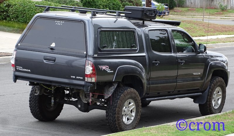

    What the truck looks like with the ass end cut off.
