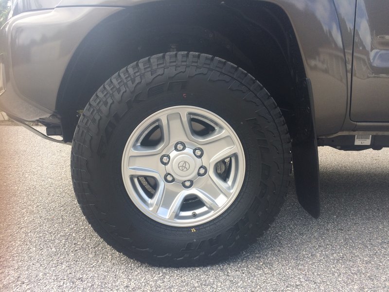

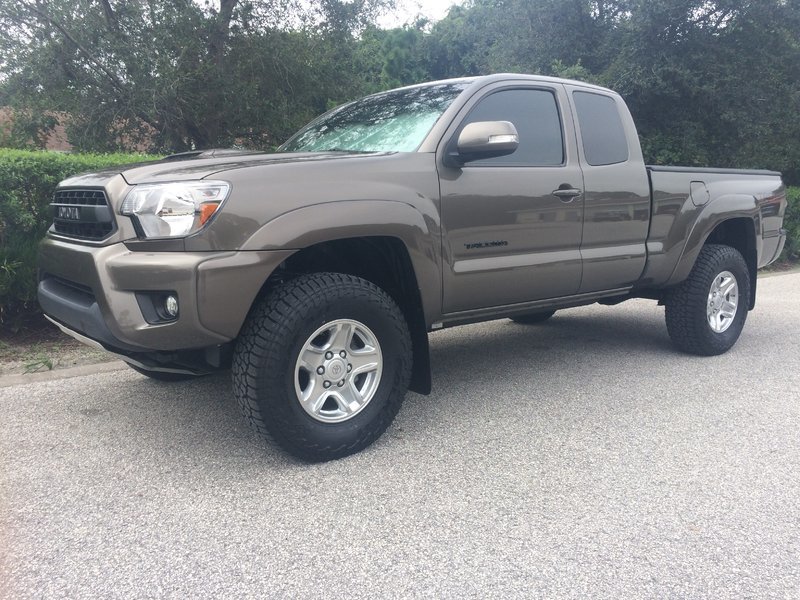

    Yeah the wheels are Bad Ass!! Thanks for the feedback on the Drilling. I'll use the same method when drilling the hood mounts for the Hood struts. Drill Bit wrapped with Electrical tape or actually use the Drill guide accessory that in most cases is never used. It always gets kicked to the curb! Need to pickup some of that 1/8" foam tape. Walmart and AMAZON are showing the same price For the Astro. Harbor Freight has a rivnut tool but I'm going with the Astro. Put my Bf Goodrich Rugged fails on CL at Lunch time today and they sold in less than 10 minutes! Here's the truck with the New Tar package. These Falkens are super Quite, I would say the equivalent to Highway Tars. Thanks Again Nick! Your Trucks Looking Awesome! :cheers:

    Truck looks great. Good call on the drill stops. Something I need to incorporate into my future work. :thumbsup:
